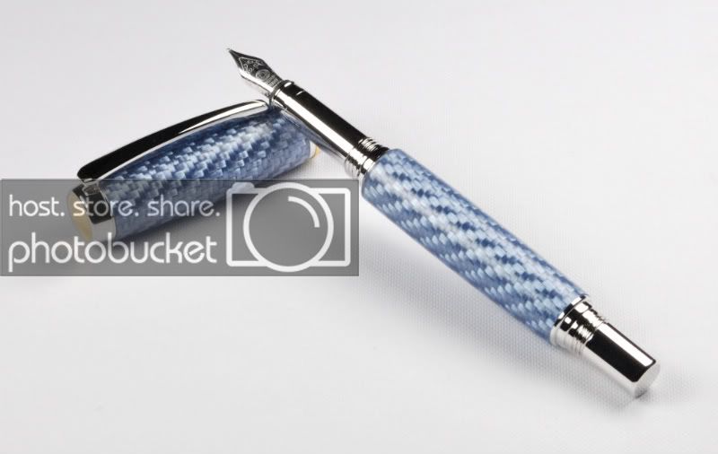

I was wondering if anyone has a supply source for Blue Glass Fiber material??? I am pretty sure it only comes in rolls or sheets and not sleeves. I am not looking for blanks. I want to use it for my own casting. I have checked some knife shops but what they sell is knife blanks and are way too expensive. It would be much appreciated. Thanks. Maybe you would also know where I could get the silver too. That would be a bonus. Thanks
Here is an example of what I am talking about. As you see it looks somewhat like CF but is not.
OK seems I am coming up blank with this. So let me ask has anyone taken the silver glass fiber and added some blue tint to the resin and came up with that blue??? I may have to get some blue dye and give it a try when I get back in my shop. These people that make those blanks have to get that glass fiber from somewhere and nothing being secret any more, one would think the source is out there.:smile: I will track this down to the ends of the earth and beyond:biggrin:

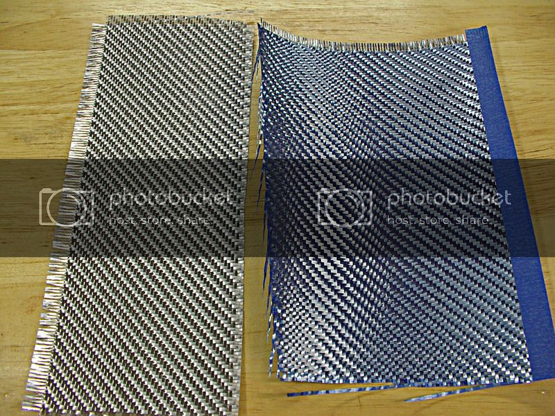

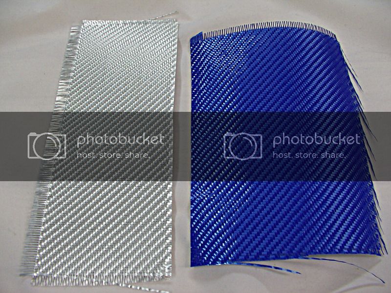

OK I got the material today and it is exactly what I was looking for. It is a blue fiberglass material. I happen to have some silver also that I put next to it. Here is a sample of it. What was unexpected was that if you turn it over it has a different look and that too can be used. If anyone is interested in this material I got it from here. The blue is showing up a tad darker than what it is. Blue Aluminized Fiberglass Fabric 2x2 Twill 50 9.14oz 310gsm [F-1614] - $29.99 : Carbon Fiber Panels/Sheets, Fabric/Cloth, COLORED Carbon/Kevlar, Composite Envisions
