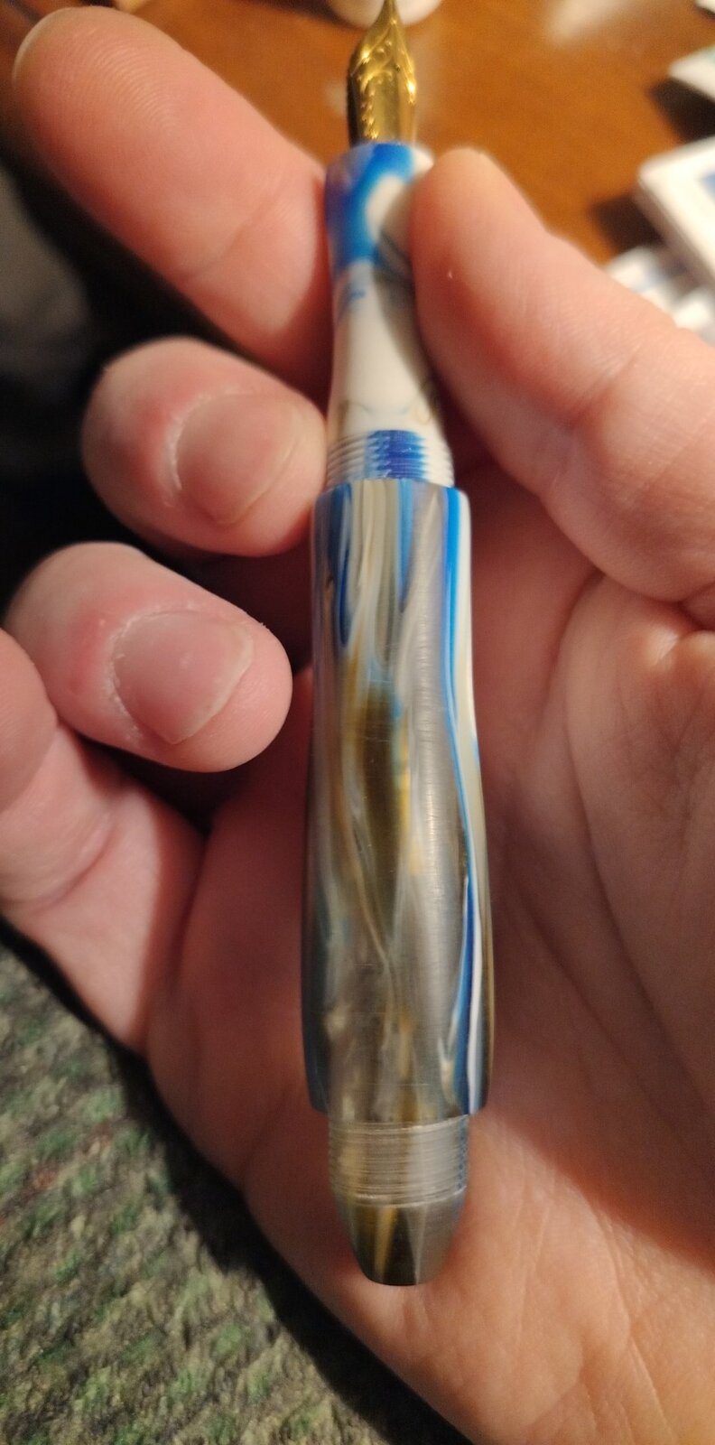

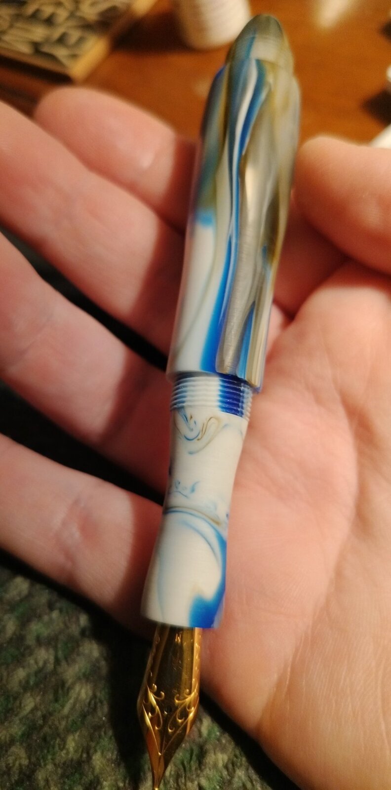

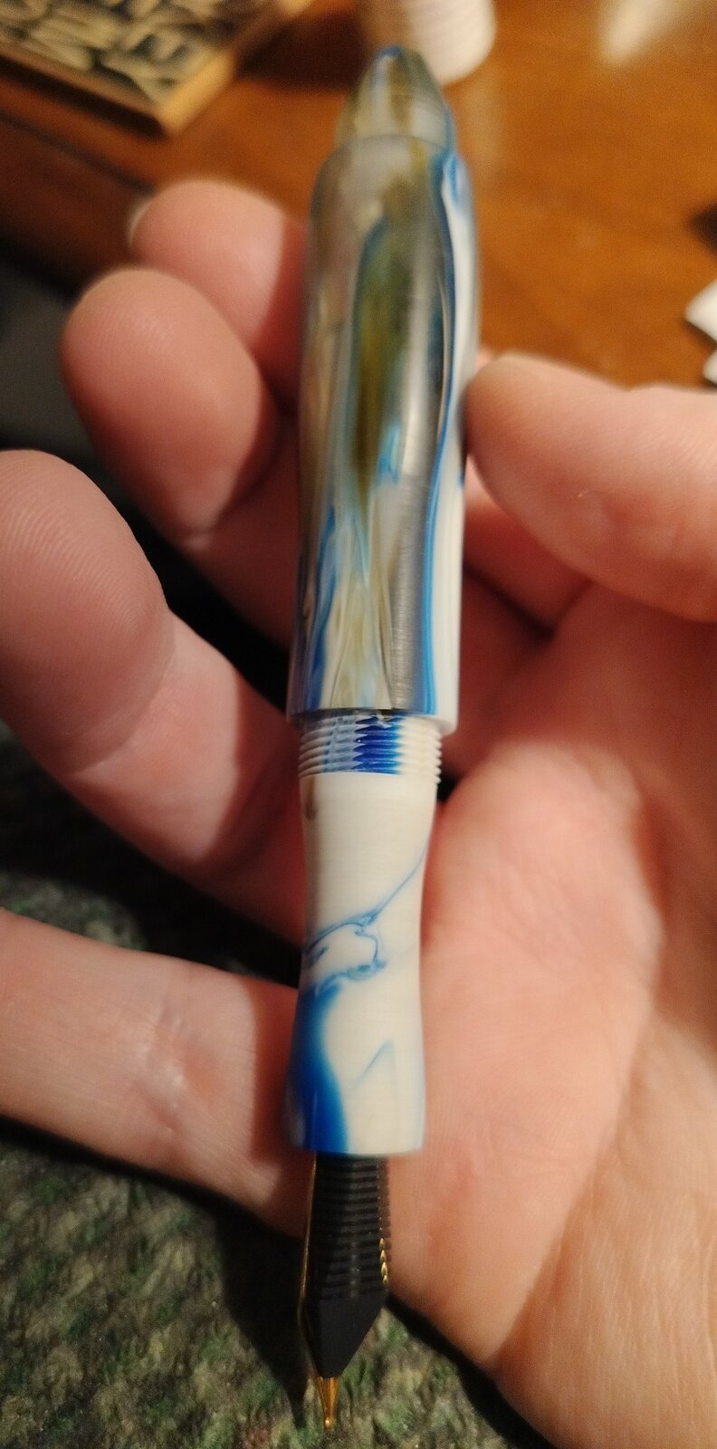

Some good news, I took an hour this evening to try out one of my alumilite blanks. Man, that is the nicest material I've ever worked with. Wow! It cuts so beautifully! And the smell is indeed very minimal. Until I was actually shaping it I barely could smell anything. I am so relieved and excited.
I didn't sand or polish it yet, but here's what I made tonight:
It turned out awesome. I'm thrilled. During my spare time the rest of the week I will complete a body and a cap. Also, I made a large order from ThePenSmiths. Lots of awesome and exciting blanks coming to me soon! In the meantime, I have two 12" blanks and two 5 inch blanks I can work with.

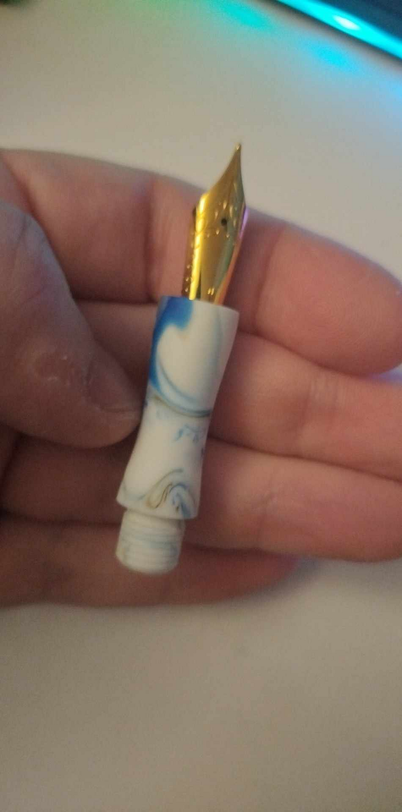

One word of advice - I see that you turned away the threads closest to where the tenon meets the main part of the section you made, here:
I used to do that but found it weakened the section and lost many to breakages at that point. So instead I now remove the first thread or two of the mating surface (inside the barrel) which solves the problem of the threads on the tenon not being fully formed all the wall to the wall.
I do the same thing for the cap-to-barrel threads - remove from inside the cap instead of making a groove around the barrel. (Mostly I do that because I think the groove looks ugly and feels nasty when I'm holding the pen, I've never had a barrel break at that point.)
I second Duncan's suggestion.
Several of the folks out on YouTube suggest this method, I know. I used to do it as well, but now, as Duncan notes, I just provide the relief on the inside of the cap and barrel threads. This avoids making weak spots weaker and for the barrel section, I prefer the look where the threads continue right into the body without that relief cut.
David
Putting the relief cut into the cap is a great idea. I will try that on my next one. I actually think the tenon relief looks kinda neat, but I think the prevailing opinion is the opposite, so I will go that route. I like the idea of doing that for the barrel too. It will also make it easier to thread them onto their mates, as well, if done that way.
Maybe try both ways and choose the one that works best for you. Your combination of tenon sizes and materials might be stronger than the ones I chose, and it won't create a weak location inclined to break the way mine did.
