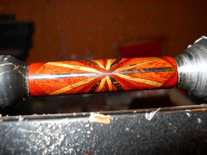

Drilled,cornered,and glueing.Will turn tomorrow.
Thanks fellas I'm glad you like it so far.I'm leaving out the details on the woods till I post it finished,but I can tell you that no power tools were used to make the blank.
All the cuts and inlay woods were done on a vintage Millers Falls mitrebox.
Thickness and squareing were done with a vintage 2x12 rasp/bastard file.
Trying to hand craft this one as much as I can.
Now that the hard part is done(drilling).I can relax a little bit.
User tip:wax your drillbits,it reduces friction and heat on the inside walls.
cant wait to see what turns out lot of work going with hand tools what does wax do to the bond when you glue would think it would interfere
I don't use wax while I drill.I just waxed the bit so that itrotates more freely in the hole.Never had any trouble glueing the tubes.If your bits squeak while drilling,wax it like you do with the ways on a lathe and try drilling again.Much quieter.

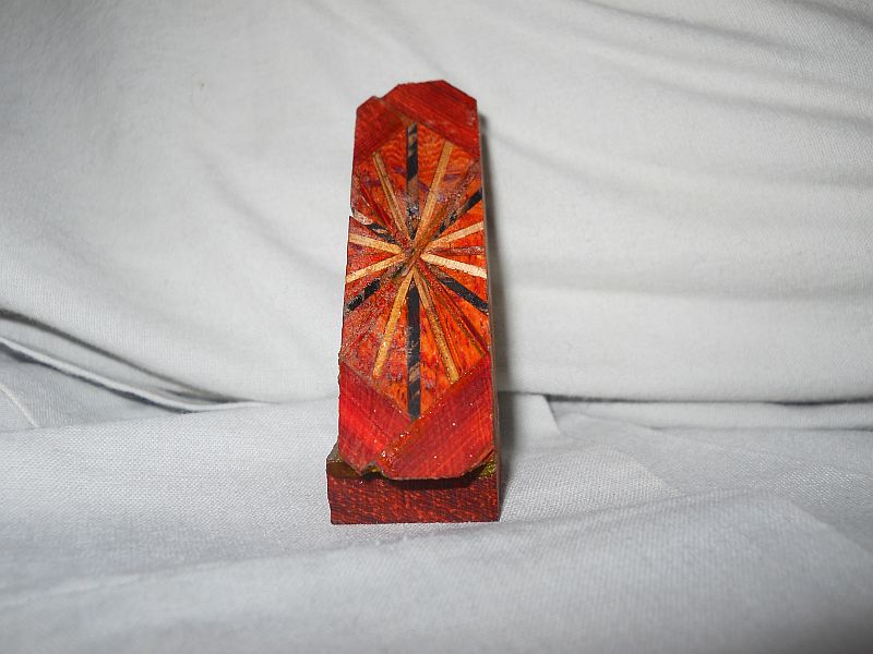

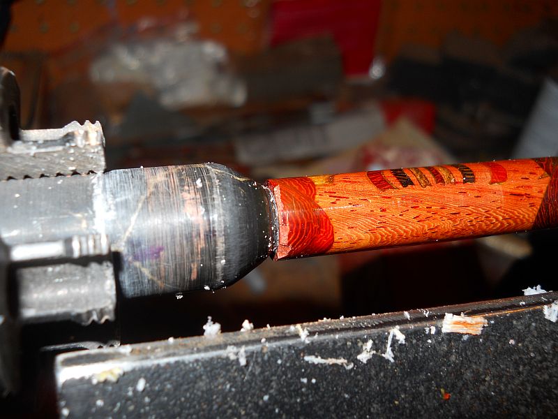

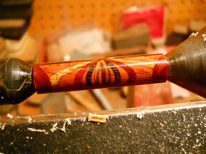

Well I almost made it.I got a catch trueing up the ends.90% loss,I can't call it a total loss because I still have an example of how the pattern turns out.
I made this blank using 4 different woods.Those are tulipwood for the main body.Wenge,zebrawood,paduk for the accents.Scallops are paduk.
The slots wer cut 4/8" deep with angles of 0,22.5,45,60,75,and 90 degrees
Gonna have to do this one again,this time while crossing my fingers and holding my tounge the right way.
Here are pics of the blank.No good to use on a pen but you can see how it turned out anyway.

No It can't be made shorter because it was intended for a rose gold aero.I'm thinking about Skiprats idea of making an oops band for both ends.Not sure how it's gonna work out but what else have I got to lose.
In my opinion, a dark oops band on each end, you could use the wenge to tie it in, would frame the design really nicely and look intentional.
...looks like you had a no hitter til the bottom of the ninth! Looking at post #19 in this thread, unless the pic is not showing it, there are not any centers ( bushings ) in the end of the pens? Maybe with a bit more support it may not have blown up?, if that were the case. Were you turning w/a skew or ?? Sorry you couldn't finish it up, looks like a blossom all set to bloom! Be well.......Jan
Janster, there are no bushings because I don't use them.The damage happed cause I was holding the skew too light on the rest while truing.
I did take Skips Idea and oopsed the ends with ebony.I am starting to believe that the catch was supposed to happen.I am building a new finish and if all goes well I'll have something to show tomorrow.
Thanks for the encouragement fellas the rescue operation is looking good.
