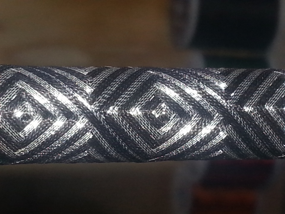

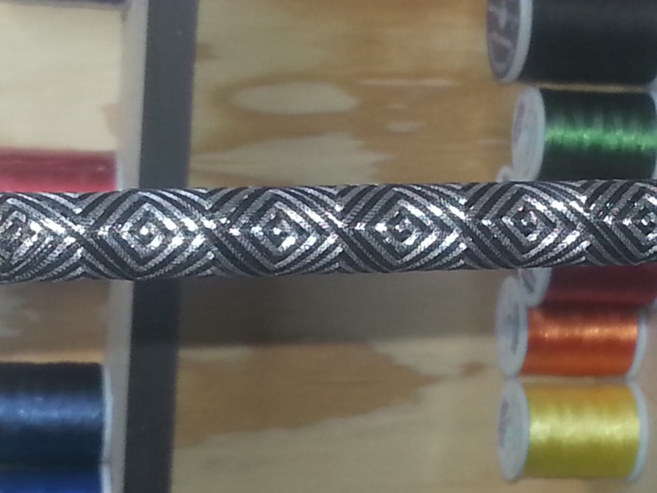

Black and Chrome Maze pattern
Ted Sachs
Oct 22, 2015
155
Uvalde, TX
I just did this one the other night right after doing a Black and Gold snowflake pattern. I had to do my Saints' colors after that awesome game Drew played Sunday. LOL I cast a couple of blanks after getting my PR the other day only to find out that PR and epoxy don't play well together. The PR will not stick to the epoxy at all. About two weeks worth of wrapping turns out to be just practice wraps. I had tried a test on first and it looked great. I found out when I tried turning it that it wasn't so great. Anyway, here's the black and chrome maze and the black and gold snowflake for y'all.
Oh, and now I"m going to try brushing some PR I'm going to mix up when I get a couple of more tubes wrapped. I'll brush on a good coat of it and stick that in the toaster oven to see if that works. Hopefully I can get something going consistently now.

I think that maze pattern is FABULOUS !!! .
That sucker is a hard wrap. It's so easy to lose your place in the order and a lot of it has to be wound on in a backwards motion. It only took about three or four hours to wrap it so it isn't that bad. I just need to make sure and put a check mark by each step as I do it. I got interrupted a couple of times and when I went back I wasn't sure which step I left at. I ended up missing a step and had to go back and undo about three steps to get the one I missed. With that pattern everything has to be done in exactly the right order or it won't come out right. Go ahead, ask me how I know. :befuddled::curse::at-wits-end:

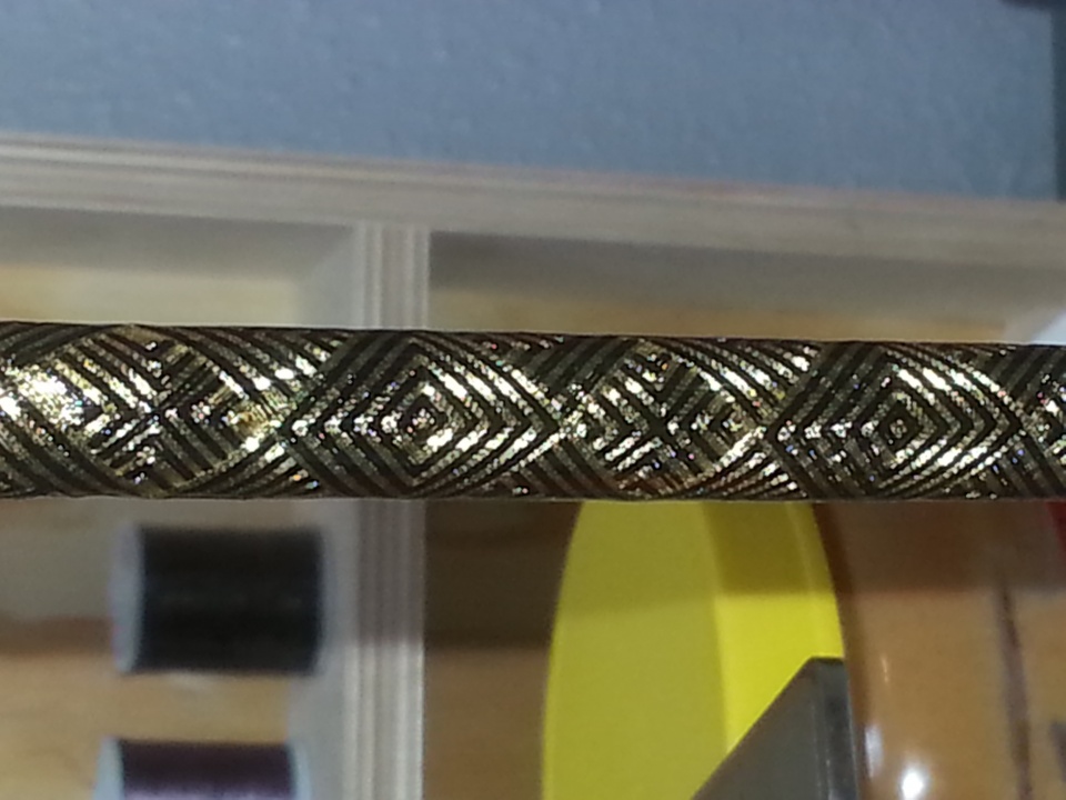

I may have sometHing along that line after the next three I've got in line. By the way, the black and gold and the black and chrome are on tubes for the Zen pen.

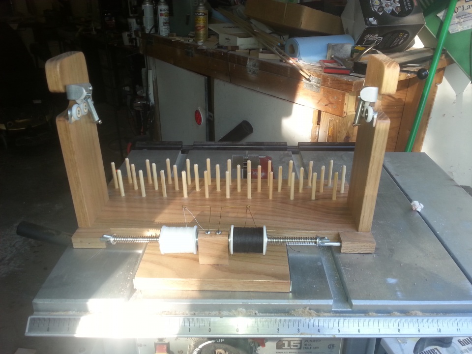

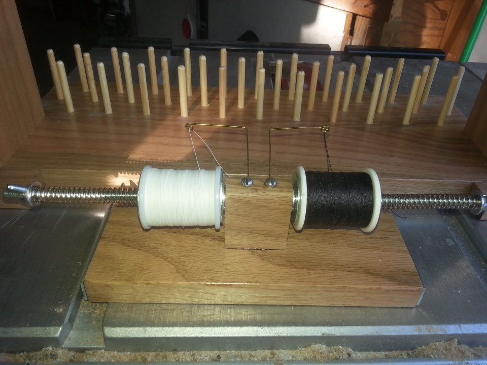

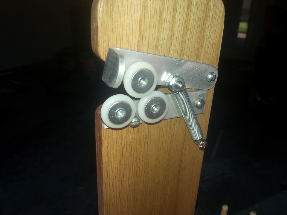

Ted, how are you making these?

Sorry for not getting back to you on this sooner. I'm wrapping thread around the brass tube like when doing fishing rods. You wrap in a spiral with a set spacing and go all the way across then back at that spacing. You then wrap on one side our the other of your first thread and on some patterns you wrap on both sides. You keep repeating this and change colors at different stages to make the pattern develop. Once finished you put a color preserver on it then brush on a couple of coats of polyester resin letting each one dry. This will lock the threads together and keep them from unraveling when you cut it off of the mandrel that you wrap on. I've attached a couple of pictures of what I use to wrap these on.
