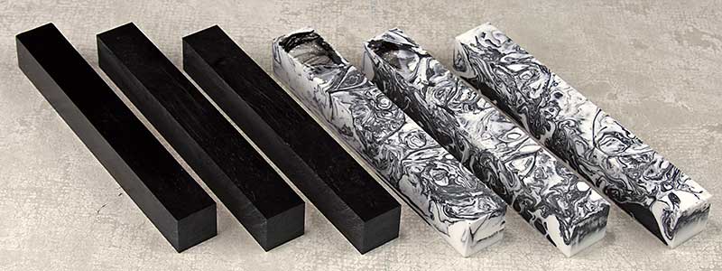

After reading Curtis' recommendation, I decided to try out some Alumilite RC3 Black. My first experience taught me not to top off the mold. This stuff can make a mess all over your saw table and pressure pot faster than you can wipe it up.
Anyway, now that I gotten most of the black off my hands (oh, and it's probably a good idea to wear disposable gloves too) and my tools (but not my floor), I can say that RC3 Black makes nice, opaque black blanks. On first try, it seems to shine up a little more easily than Alumilite Clear does.
Since it has a set-up time about the same as Alumilite White, I decided to try pouring the two together and see if they are compatible. I haven't turned a pen from the blanks yet, but so far the resuts look promising.

I made a pen from the blank on the far right, and it turned quite nicely. It seems that the Alumilite White and the Alumilite RC3 Black are indeed compatible. The blank turned just like regular Alumilite. It polished up pretty well too. You can see the result at http://www.penturners.org/forum/f13/two-faced-97362/.

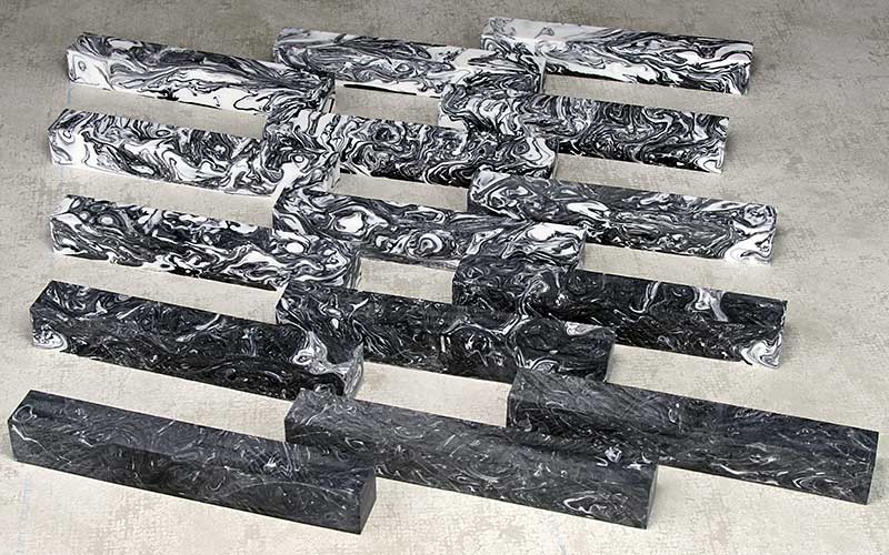

More fun with mixing
I've been experimenting more with mixing the two resins. Believe it or not, all the blanks below were made with the same ratio of black to white. The only difference is the way the two were poured together.
attachment.php
To me, the top row looks like white with black lines. The second looks predominately white on one side and black on the other. The third row looks mostly black. The fourth is definitely black with thin white streaks. I'd characterize the bottom row as "charcoal marble".
I can only surmise that the dye in Alumilite Black is very potent. It easily overwhelms the white when the two are mixed.
I hope that proves interesting.
Regards,
Eric
