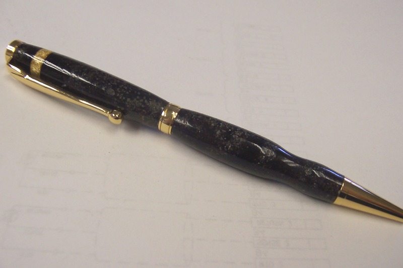

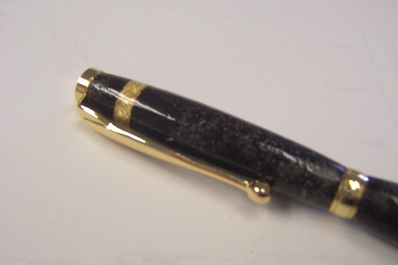

Brandon,
The coffee grounds came out great, considering I did not put enuff patience into finishing it. Here is one made about a year+ ago with gold leaf used as an accent band. Give it a try. The pics not that great. I'll try to snap a better one tonight.
