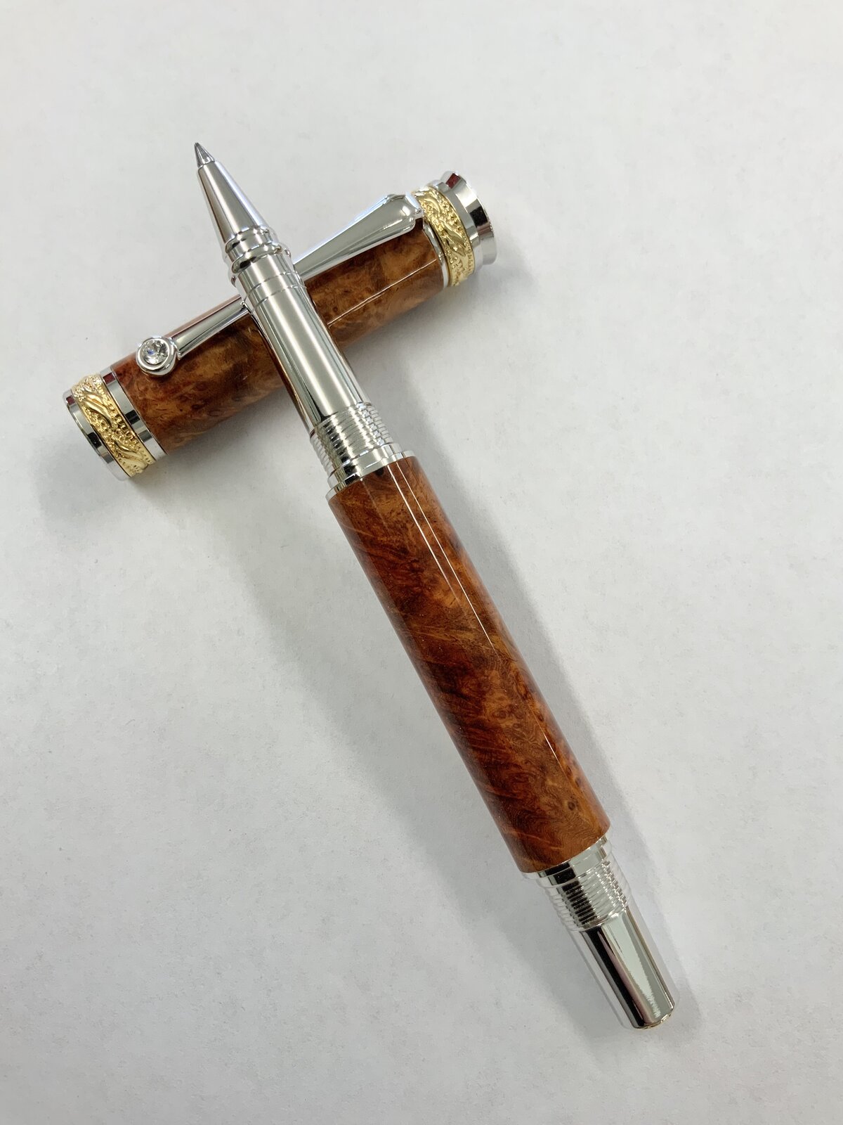

Learned a lot from this site and admire lots of the work seen here. Want to make more rollerballs and looking on numerous pen kit sites but getting dizzy trying to sort out the best kits from the junk, same pen different name, some sites provide very little detail, etc. it's maddening. Wasted too much time already buying junk kits. My question is this... cost not being a factor, what are the best overall quality rollerball kits by name and where to get them??? Thanks in advance your help.

If you want a two-barrel pen, then my recommendation is the Jr. Emperor rollerball pen kit, available at ExoticBlanks.com :
I like the styling and appearance of the Jr. Emperor much better than the pen that you show above, which I think is the Jr. Majestic.
