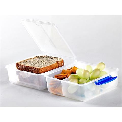

Check out the klip it lunch cube/container at Bed Bath and Beyond. They have 3 sections with dividers for pouring 3 different size slabs. I picked one up for $6. Worked well so far.
