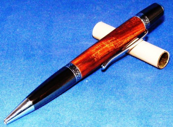

This is with the new Fujifilm S500 we got in December. The setting is the stock Wlamart light tent with one light into the side and the other pointing directly at the pen from above the camera. And I think I used the flash on this one as the others were all darker.
I finally figured out how to use manual focus and macro/supermacro on the camera. But now what else can I do to improve the shots?
I want to list some on Pen Mall, but am holding off until I can get good pictures to go up.

For starters, I would change the blue backdrop. I would also try not aiming the light directly at the pen.

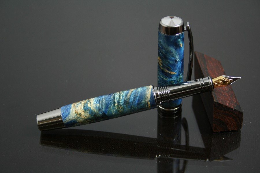

My latest pictures were taken with the camera on Aperture Priority at 5.6 at 55MM.
I had only one small CFL bulb pointed up-wards from the outside of the tent, which was the single biggest improvement, as I had way too much light coming in before.
I changed the white backdrop to a gray glass (wanted a gloss effect) with dark fabric under it to make it even darker.
I used the timer so as not the rock the camera and used the manual focus.
I have gone from taking dozens of pictures to get a decent shot to one or two. This is the end result.

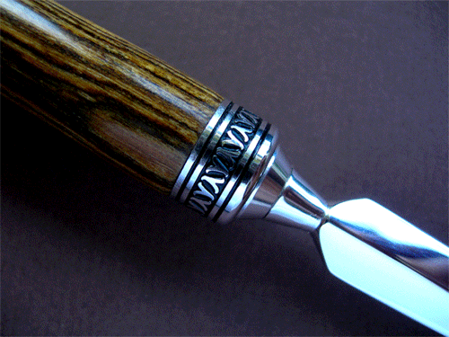

Here is a pen using the same setup. (excuse the dust...[:I])

The picture has too much contrast and color saturation. Is it straight out of the camera or did you post-process it?
It looks like it was post-processed in Picasa. I used to use Picasa and pictures that are over-processed in Picasa have a fairly distinctive look.
What resolution are you using? Your should be shooting at maximum resolution, 3072x2304.

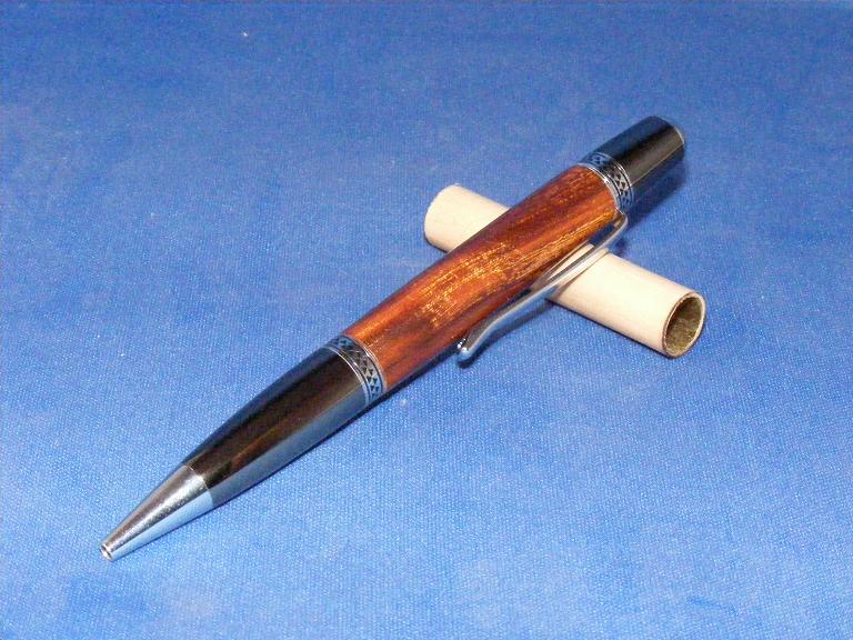

Can you post the same picture just as it comes from the camera, nothing more than re-sizing?
straight from the camera (reduced to 25% of original size in MS Paint). Not sure which program I have on my Dell Laptop but I used it for cropping and I may have hit the "auto correct" button on it while playing around.
That's a better looking photo although, to me, it still looks a bit over-processed. Are there any settings on your camera to increase saturation or contrast? Saturation might be referred to as "vivid." Is the background really that blue?
Are you shooting at the highest resolution?
The original matched the 3072x2304 you mentioned above.
As to camera settings.For now the camera is on the defaults other than me putting it in manual focus mode, macro or supermacro, and using or killing the flash.
I don't believe I've accidentally changed anything else, but it's possible.
The blue backgrouud is the stock blue background that came with the walmart light tent. I may flip it to the gray side and see how that does. I'll get some more pics taken this week.
Mike,
Definitely try the gray background on the next one. The blue is too intense and distracting. Check the camera settings and make sure that if there is anything for something like "color mode" or saturation that it isn't set to vivid or that the saturation isn't set higher than normal. Also, put the pen more parallel to the camera back which makes it easier to get the entire pen in focus. Also, post it in a new thread so we don't have to scroll through all the pictures taken by someone else.

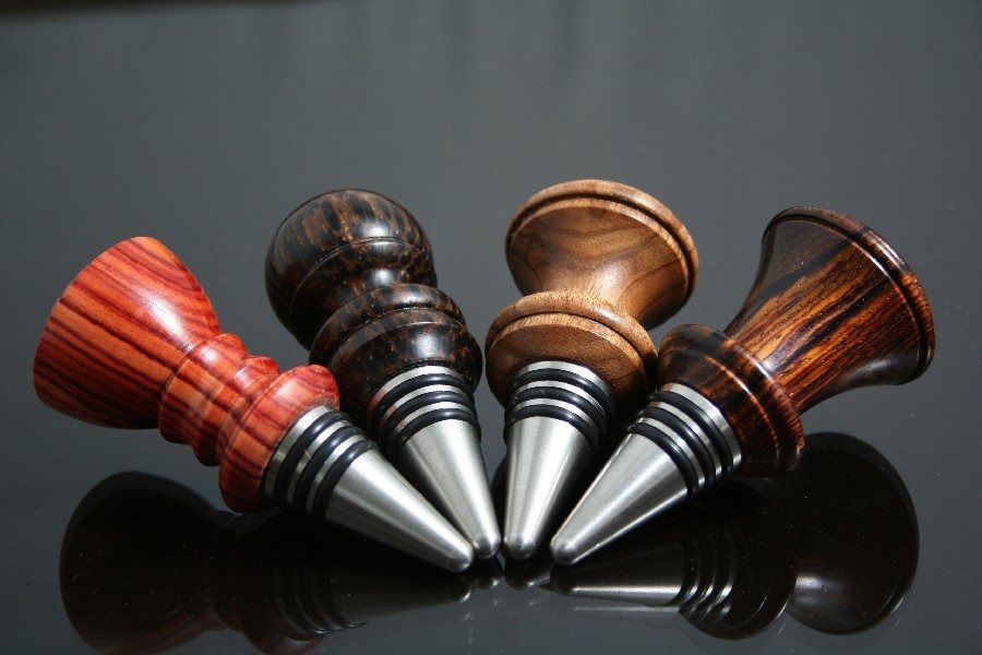

i took this through a window, in bright soft daylight, reflecting back on the subject. essentially the same a using one lamp. i cant control the intensity of the sun but i can diffuse it with a white gauze or move the subject further away from the window. your light tent is no different. the advantage you have is you can take the picture when ever you want. lucky you.
this was taken with a compact and i'm saying this because you can get good results from a small simple camera. using auto mode and macro. essentially its all about using light and understanding and working within the limits of yor equipment.
