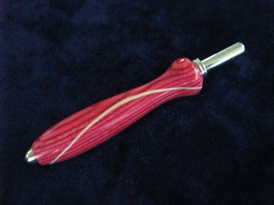

Titebond worked for me.
Thanks for the heads up on the sales. I missed out on the larger blanks. I've got the blank halfway done, just have some sanding then a few more cuts & gluing to do. I've been busy with other things so it's sitting on a table waiting for me to get around to it. So far my idea seems like it will work.
