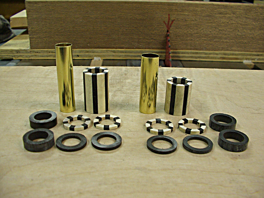

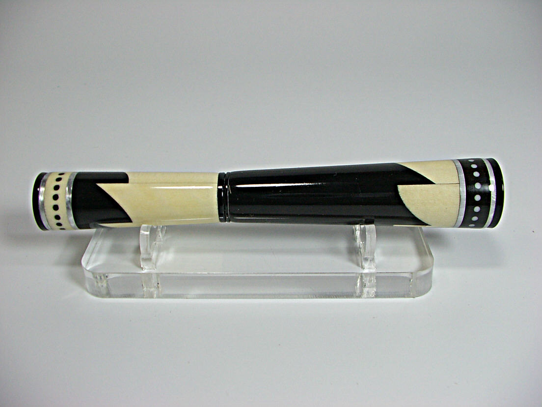

Jon I do not know exactly the type blanks you are building but if you are just building blanks with round rings and spaces in between then do as I do and drill before you assemble and do a build on the tube blank. this way you eliminated the drilling stress. There are times that you can not but many pens I see made here with segments fall into that category and easily be built on a tube. here is an example.
By the way these were glued with T88 because I use T88 to glue my blanks to the tube and this way I killed 2 birds with one glue up.

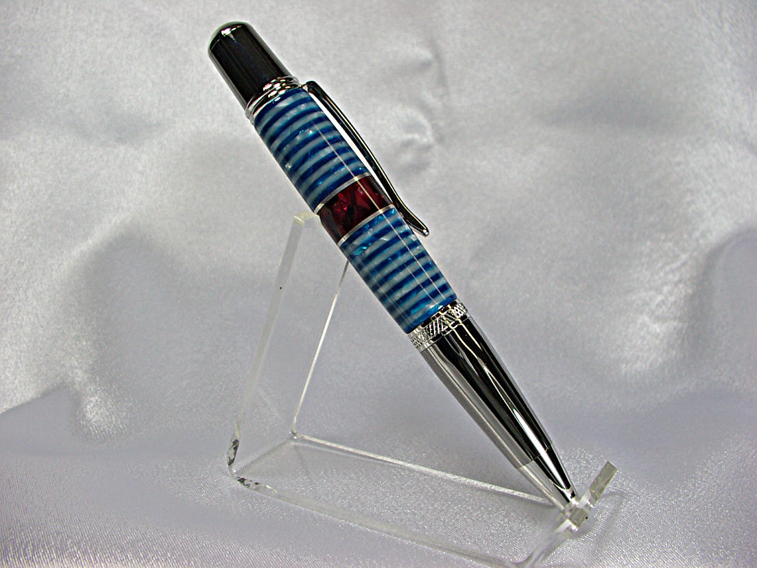

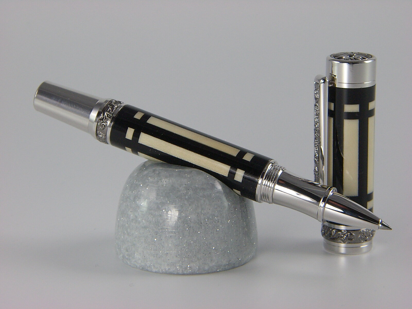

@jttheclockman I actually did try that with other blanks that have these thin metal layers. I have thus far been unsuccessful drilling the metal on its own. I guess I've had trouble doign that with thinner wood and resin segments as well. I just don't know of a good way to hold them in place, other than trying to use the same types of glue to stick em to some kind of sacrificial piece of wood...but I doubt that would really work with the metals.
So, you use a lot of ebony and holly, it looks like. I really like the way those two go together, especially with chrome pens. I see what you've done there with those layers. For the thinner ones, though, even though they are not as thin as my metal layers, they do still seem a bit thin. How do you hold them in place and get the bit centered on them?

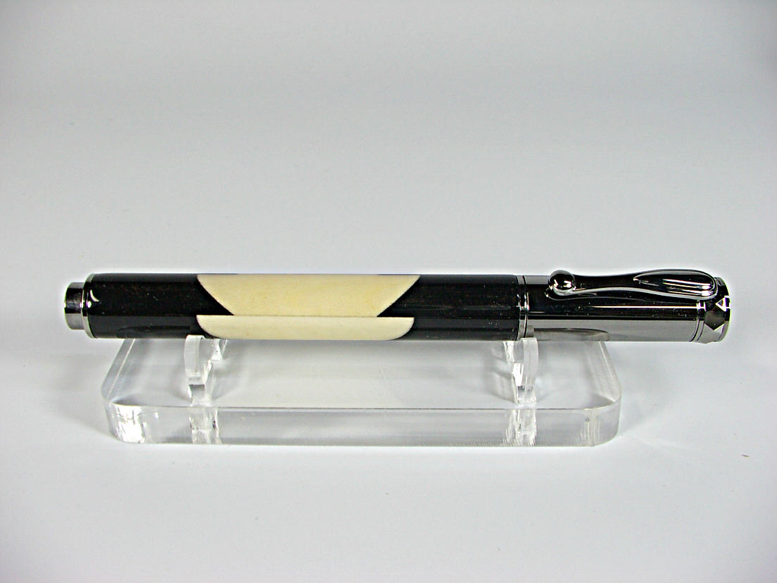

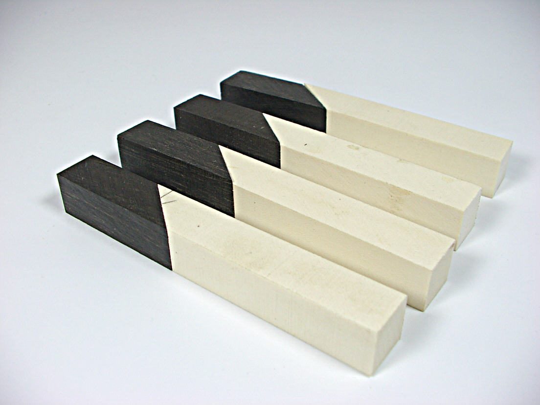

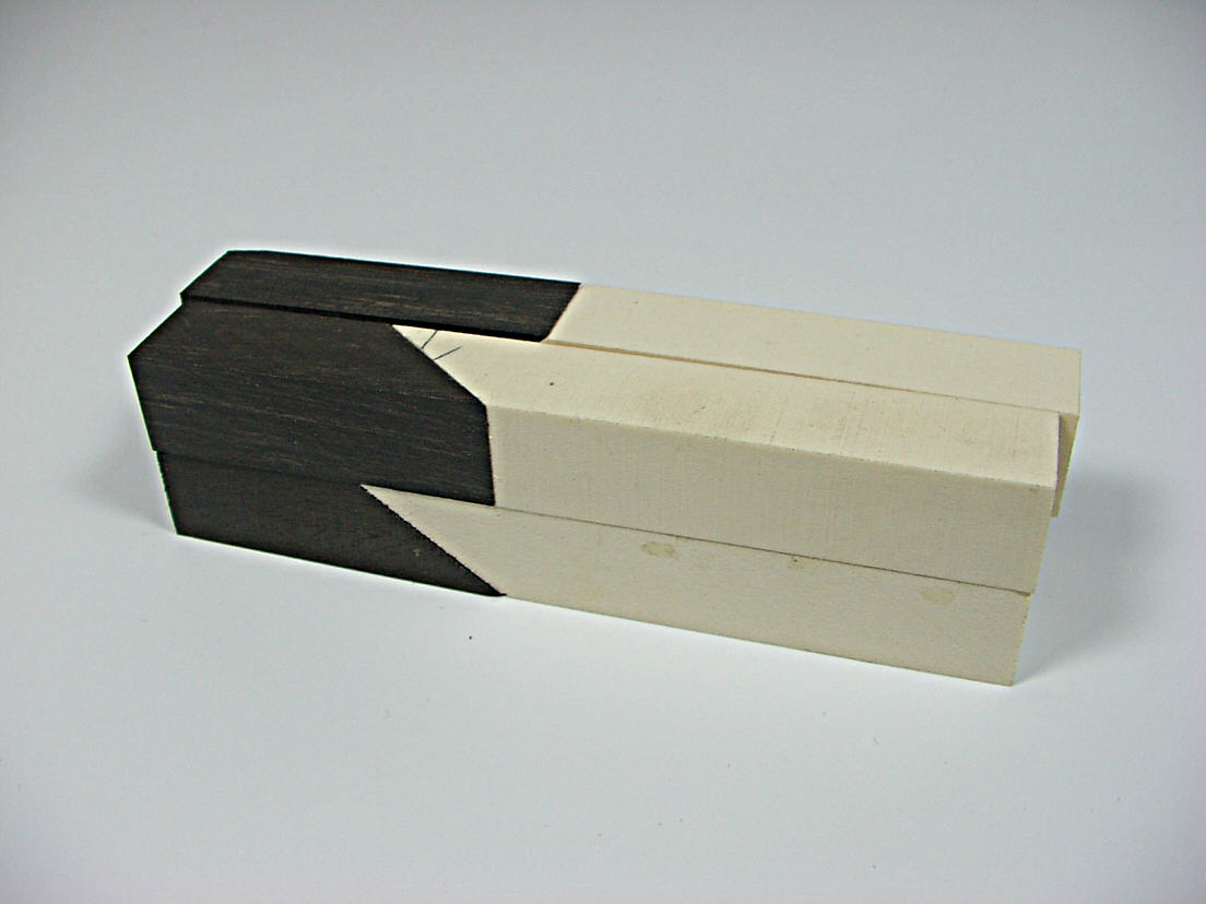

Jon many times you have to think outside the box. That particular example, the blank was one large piece and I drilled it. Then I cut the slices on my tablesaw with a jig which is actually behind the pieces.
To drill thin metals, sandwich them between a couple pieces of scrap wood and either clamp them or nail them. What I like to do is use a larger piece of metal, drill my holes and then cut the metal to size I want. I never drill holes in small pieces unless I have to and then use some sort of sandwich. An advantage I have is I have a scrollsaw and am a scroller so I can make a jig that can hold small pieces steady. I made this guitar pick pen and had to glue a bunch of picks together. now using that epoxy they were as slippery as a wet eel. So I cut a jig the shape of the picks and stacked them in there and clamped together. Now they formed a blank and were all stacked nicely. It was then very easy to drill a hole down the center of all the picks. I lined the jig with wax paper so the blank came out of jig easily. Here is the pen and the blank I shown you in an earlier photo. Segmenting requires many jigs if you are going to go beyond the basic segmenting rings. That is what makes it fun and interesting. The pick blank is right behind the rope blanks.

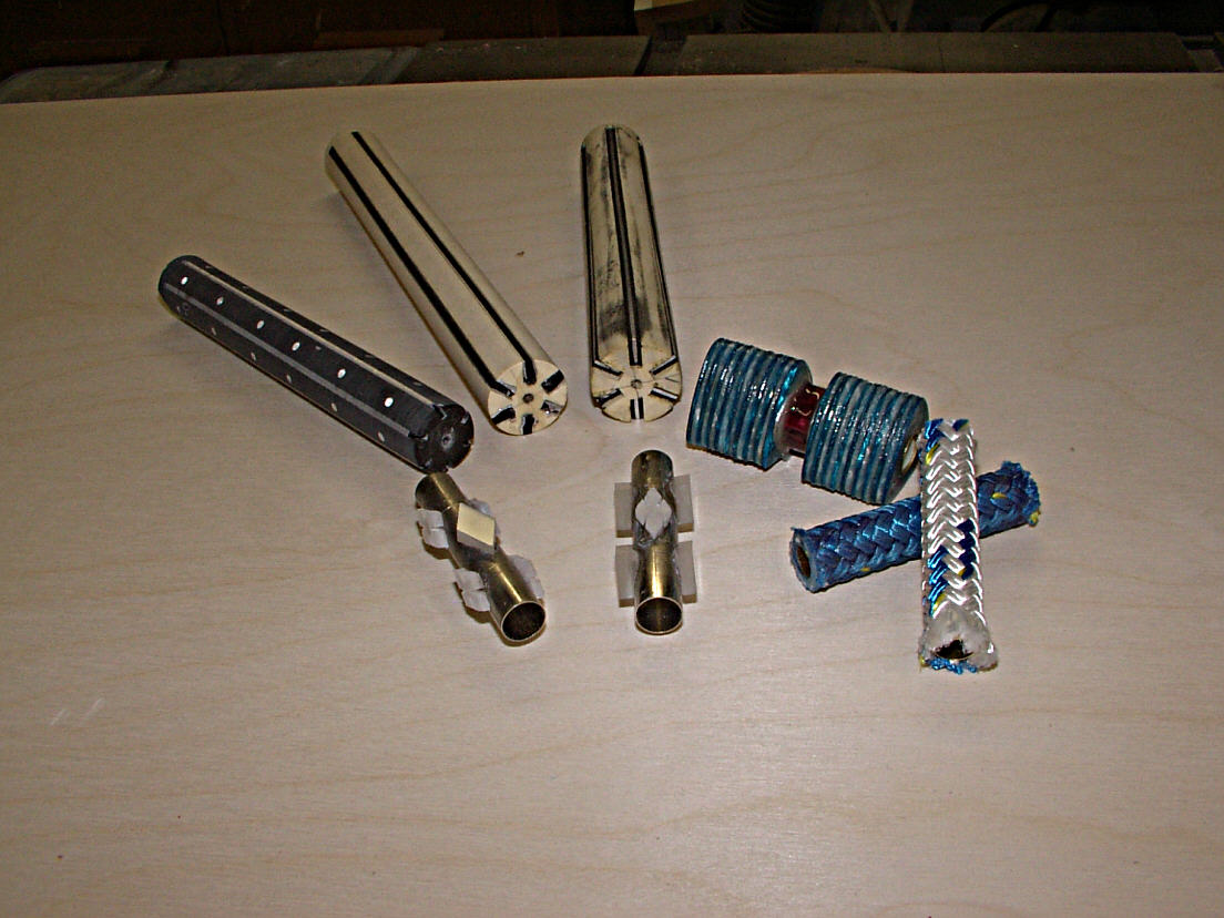

Other things to consider, it's not always about the glue. Sometimes its the drill bit, and sometimes it's your(my), technique and as you already mentioned sometimes, it's impatience.
