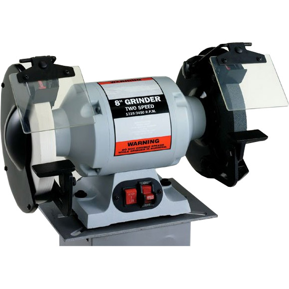

My opinion, would to go with the one from Woodcraft. The have two nice ones, one for $99 and one for $122
The $99 one has two "proper" sharpening wheels, not grinding wheels 60 & 120 grit, plus it's a 1750rpm grinder. Well suited for jig set ups.
http://www.woodcraft.com/family.aspx?familyid=4605
Now the more expensive one is nice because it has a 60 grit grinding wheel, and a 120 grit sharpening wheel. The other advantage is that it's a two speed grinder for 1750 & 3400 rpm.
http://www.woodcraft.com/family.aspx?familyid=4606
Now with that said, I do kind of like that $70.00 grinder that sears is selling and might pick one up myself just becasue of how close they are to me. You can buy a 6" sharpening wheel at Woodcraft for $20.00, but you will be stuck with a 6" grinder. I use mostly skews and hand sharpen them 90% of the time, but what I need is a grinder for my metal lathe bits and this one looks like a nice choice.
I also agree with not buying the 6" go for the 8". Also purchase a diamond wheel dresser. My Woodcraft grinding wheels were a bit out of round and this will make quick work to true them up.
You know... Rockler has a Delta VS 8" grinder for $139.00 and might be a better choice than the Woodcraft one. with a 36 grit cutting wheel and a 60 grit sharpening wheel. I think that one might be the best choice of all. The down side, you only get one white wheel, but the plus side is you are not tempted to "abuse" the white wheels to grind a bolt or something.
EDIT: Or at Lowes for $125.10 [:I]
http://www.rockler.com/product.cfm?page=18287&filter=grinder%2E
