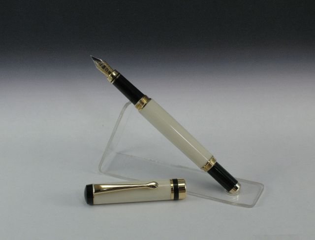

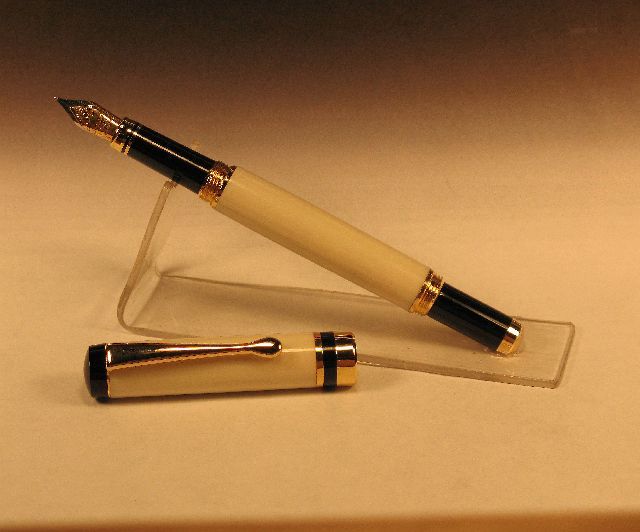

This is what I came up with. I'm pretty much satisfied with the after photo other than it doesn't show the shine like I want it to. I'm not using any photo editing software at all. I'm now using a plastic frosted color tote to diffuse my 3 lights (1 each side, 1 top)and I've got one in front (undiffused)to help show the shine.
Before
After
I think you have the color balance correct, but the picture is probably 1 stop under-exposed, possibly 1-1/2 stops. You can put the white paper in the same light, set the f-stop to f8 or f11(better), set the camera to aperture priority, point the camera at the paper, making sure the paper fills the whole frame and depress the shutter release about half way until it shows you what the shutter speed is. Write that down. Now switch the camera to manual and set the shutter speed to what you wrote down. To compensate for the white paper, you must now either open the aperture 2 full stops, or decrease the shutter speed by 1/2 two times or a combination. For instance if you had the camera set to f8 and it showed 1/60 for the shutter speed, I would recommend you reduce the shutter speed to 1/15 and of course use a tripod. You could also reduce the f-stop to 5.6 and decrease the shutter speed to 1/30, but you should use the smallest f-stop possible to maximize the depth of field.
Very nice photo. I think you got the mechanics down, now you'll just have to play with the artistic side of composition, lighting, etc. until you find the shine you're looking for. Have fun. [8D]
