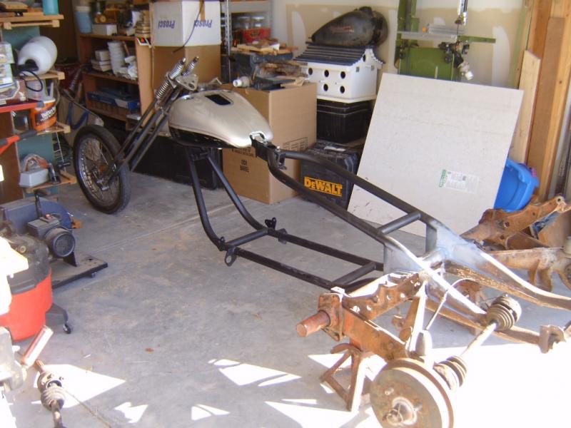

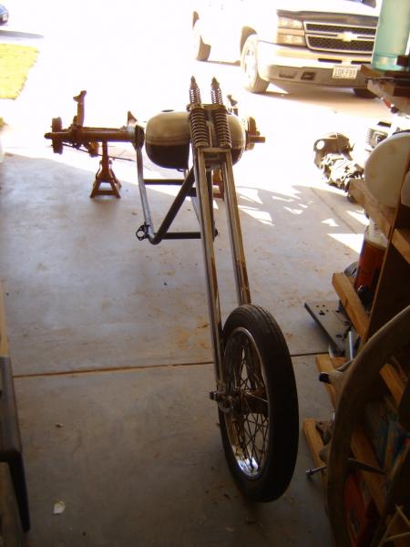

I thought I'd post a little tease of what I've been working on that's been keeping me away.
Looks to me like a Harley Davidson 2003 (Anniversary Edition) tank with a FXD frame and a homebrew (custom) Springer/FXD fork with extended rake, that is about to be triked with a (Volkswagon Beetle?) rear axle?
Am I close?
Am I close?
Definitely close. Tank is dead on, forks are about the same thing I figured (got them at a swapmeet and the guy wasn't sure), frame is actually custom built trike frame from Wildman Trikes out of Florida, and it is coupled with a VW IRS (Independent Rear Suspension).
I currently have a standard tranny for it, but will be picking up an autostick next week when I go get my engine (1600 cc rebuild). I have a disc brake conversion kit coming w/5 X 4 3/4 bolt pattern. All that's left to do is figure out what seat I want, and what kind of fenders and sheet metal to shape to fill unsightly voids. Then I can take it apart and get it to the powder coater and painter.
