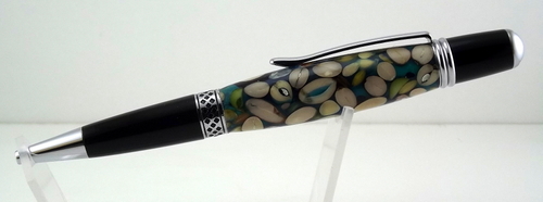

Bean Soup Mix cast in PR
Reverse Painted black
Mesa with Chrome finish
Might be a while before I do another one of these.

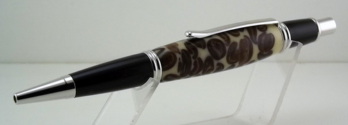

Coffee Bean cast in PR
Reverse painted white
Gatsby Click Rhodium finish
Comments welcome, especially on photos, camera is much smarter
than me.

How much thin CA did you need to use to keep all the beans happy? Or did you get lucky and not eject any of them?

These are great, I tried one with popcorn and my idea was greater than my final project.
Had few pop outs, kept the skew sharp and turned at 1220 rpm
Still went thru quite a bit of CA tho, 20 coats of thin and thick.
The spice mix is in the pot with the remainder of the beans.

Very nice set of pens. When you add that many coats of CA to the pen how do you keep the tube from sticking to the bushings? I have a hard time getting it all apart after the CA process.
