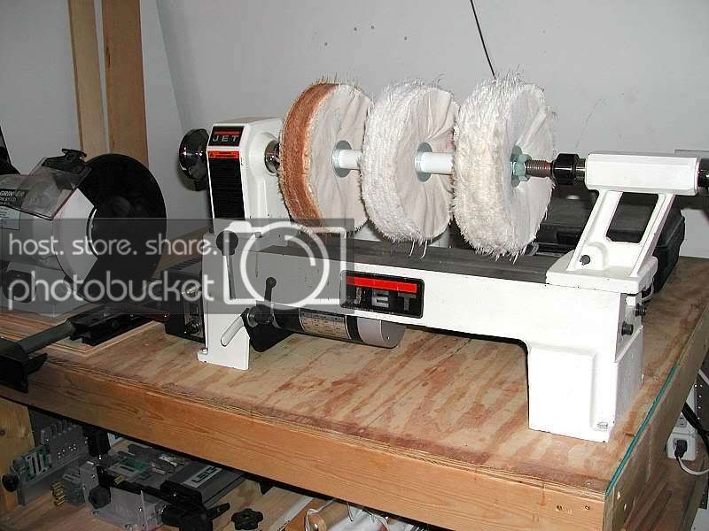

I have the one with three wheels and it fits on my Jet mini VS.

Build your own..... I did a two wheel set up and it work great. The third wheel is on it's original mandrel. THis give me more room to work with as I am buffing pieces.

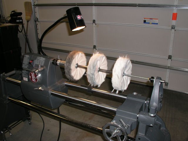

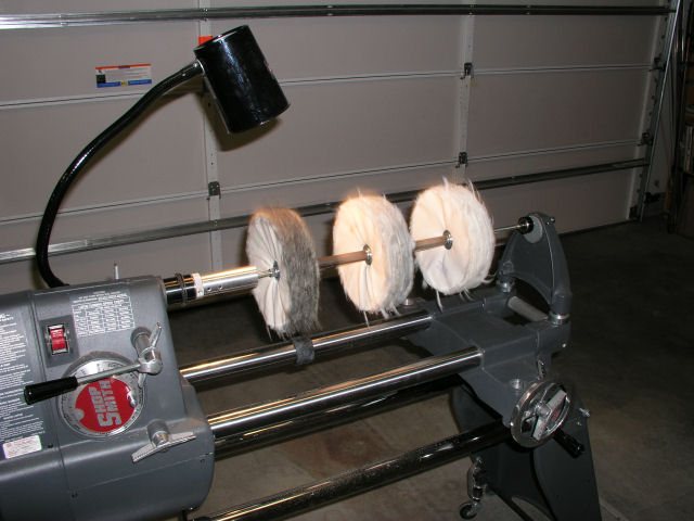

I've had my Beall Buffing System for several weeks now and got tired of having to change from wheel to wheel so I made my own Three On style by mounting it between centers on my Shopsmith. I bought some 3/8" inch threaded rod along with some nuts and washers to hold each of the wheels on the shaft. It works great except that I have to keep the speed down to 800 or less to prevent excessive vibration of the wheels. I also have found that I get a lot of static electricity build-up when buffing and am constantly getting zapped when I come near a metal part of the lathe. Otherwise, not having to change-out the wheels makes pen buffing much quicker. See the attached pictures of my setup:

Don: I wonder if your vibration is due to some flexing in your mandrel shaft. The Beall 3 on 1 system uses a 3/4" mandrel and most of the home-built ones I have seen described on IAP have used at least 1/2" mandrels.
