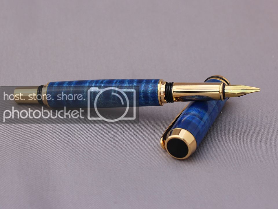

It's been a while since I've posted anything, but here's my latest. It's a Ti Gold Baron fountain pen with 1.5mm nib, dressed in curly maple dyed with Noodler's Baystate Blue fountain pen ink, finished with CA, and knocked back the gloss to a semi-gloss level. The pen is inked, with Baystate Blue, of course, and writes great!
As always, comments/critiques are welcome.

This is the first time I tried it. With Baystate Blue, I love the vivid cobalt blue color, but I'm not sure how it will hold over time. It is listed as a waterproof ink, but not one of Noodler's "Bulletproof" inks. I'll be using this one myself, in an office environment under fluorescent lighting, but I'll test it over time.
I'd think that some other colors that are listed as "Bulletproof" might be a better choice due to the UV resistance, and wouldn't be as prone to fading.
Really, really like the pen (it ROCKS). The fit is spot on, finish is also really nice. I love a high gloss so wish you had gone that way.
Really like the clarity and detail in the photo, can you supply and details on the taking of the picture.
I love it. I am curious how you stained it though. Did you just wipe on the ink after sanding? If so just one or many coats? It is gorgeous!
Mitch -- I sanded first to 1000-grit, wiped the dust off with denatured alcohol, then a thorough wipedown with a paper towel dipped into the ink bottle, with the lathe off. After about 30 seconds dry time or so, I turned the lathe off and burnished the color with a paper towel. The tiger stripes didn't show up as pronounced as I had hoped, so I gave a quick wipe with the alcohol again, and that made the stripes pop. So only one coat of this ink was needed. Different inks may not be as brilliant, some look chalky, and some look watered down, at least on paper.

Is the nib 'ground' for calligraphy? or am I seeing something weird?

No, you're not seeing anything weird with the nib, but I didn't grind it like that. I bought several of these caligraphy nibs a couple of years ago during the Super Wednesday clearance sale at Craft Supplies, but I see they're still on their website here:
Artisan Calligraphy #5 Fountain Pen Nib | Pen Making | Craft Supplies USA
These nibs are wet and will place alot of ink on the paper. I'm a lefty, so I pretty much only use this nib for my signatures, since it's short enough that I don't get hand swipe across it when I write!
Thanks John -- I'm no photographer by any means. I take more action pictures of my kids at ball fields than anything.
For pens and small things, when I take the time to dig it out, I have a small photo white cube tent with a piece of grey cotton fabric laid down on the inside. I have a Canon T3i with the stock lens that came with it.
For this picture, I set the photo cube up outside on top of my bbq grill lid, skies were slightly overcast but still sunny, camera set on auto, no tripod, deep breath, and snapped the picture. Other than cropping it to size for this forum, no photoshopping was done for color adjustment, etc. (I know there are focus problems, etc., with it, but for sharing on a forum, it works for me!)
