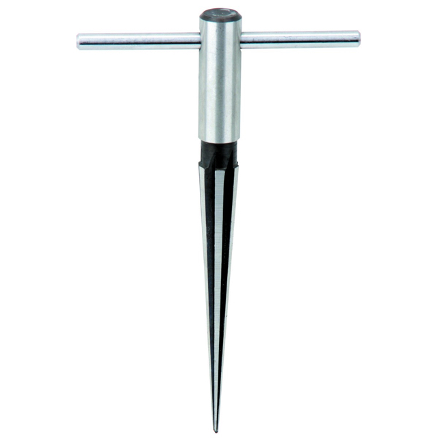

Even with a razor sharp barrel trimmer you can still get a burr. I use the deburring tool even if I sand instead of a barrel trimer. Eases assembly an cheap insurance.
Here it what I use and a steal at $3 from Harbor Freight.
. Great for deburring and removing glue from inside the tubes. The long taper is forgiving and won't over chamfer the ends of the tubes.
