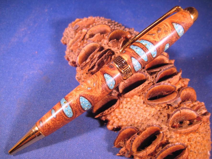

I'd definately like to see a picture of your Banksia pen.
Found my supplier and have pods coming soon. Turning them just takes very sharp tools and even sharper for turning when the turquoise stone is in the holes. Here a recent one......

The ones I have gotten from Rod Rice are bigger than normal, nice and dry and he only charges $8 each. Should be able to get 4-6 pens from each pod. Turquoise is just about as expensive as the pod. I've been paying $18 for an ounce and that is only about 2 teaspoons worth. If you are careful, it will do about 6 pens. The stone is really hard on chisels but you can eventually cut it flush with the wood. It does polish up good with 6000 MM. These pens have sold really well so they are worth the extra work. Takes about 2 1/2 to 3 hours to make one pen. Maybe less if you set up to do 3-4 at a time.

Didn't have to stabilize the blanks at all. Did have to fill in some small tear outs and of course, used a fair amount of CA setting the turquoise in the seed holes but it turned fairly well. I did have several that exploded while turning that were discarded but I did get a few to come out OK. These pods are about 4" in diameter and maybe 8-10" long. The outer layer is useless for pens so I cut off slices about 1/2-3/4" thick before taking blanks.
As with everything, the chisels have to be razor sharp. In turning one complete pen, I probably sharpened my tools about 15 times. I start with a 1" gouge and end up with the skew. The turquoise is really tough on the chisels. It takes 3-4 hours to turn one of these pens but I really think it is worth the time.
