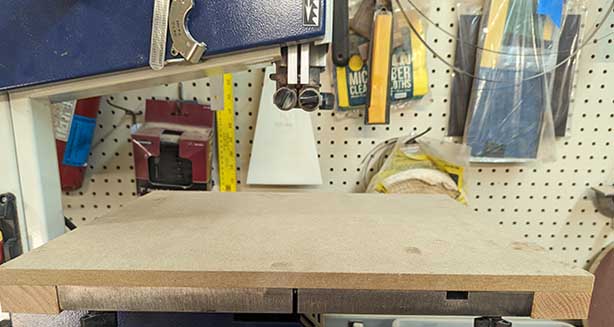

I've given up on finding the 5/8 adjustable bars. Today I tried 2 thing is the sled dept. The first was to attach 2 runners to slide against the outside of the table. I was pleasani tly surprised as it worked very well. No slop at all. The second was a plastic cutting board from the kitchen (please don't tell my wife} and made a runner. I cut it close and then finetuned it with my micro thickness sander to within a couple of thousandths. That was screwed to a piece of 3/4 melamine board and that worked good also. The melamine slides nicely. thanks for all the suggestions

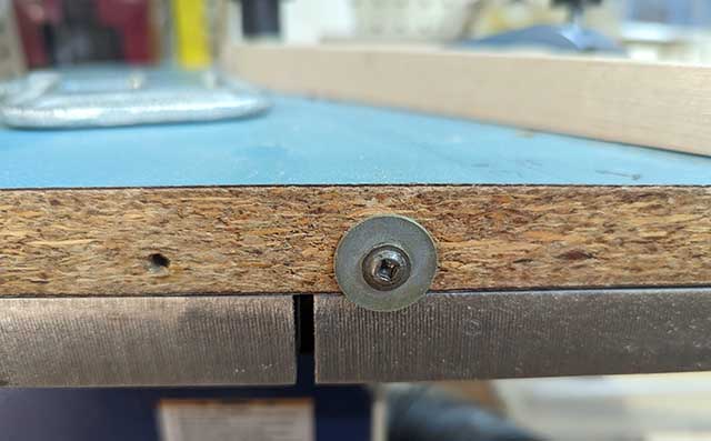

My experiment was a runner on both side of the table leaving the slot empty. There was no play and much easier than messing with the slot. Most of the time I prefer to have support under the cut off so the thought of only using one side of the table never even crossed my mind. I'm attaching 2 photos, one of my very simple "stop" so I didn't cut my sled in half. The other photo is the dual runners. I won't actually finish the dual runner sled as the top is way to flimsy. Just having fun and experimenting.
Yep. Something like this would work just fine and you can build off it with tracks and clamps and the whole nine yards. I have a project that I want to slice billiard balls in half and this is going to be what I start with also. That project is so far down the list. That gets back into my scrolling projects and other ideas.
