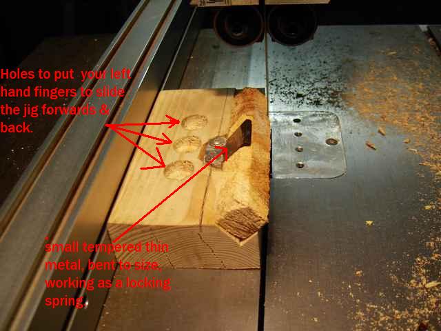

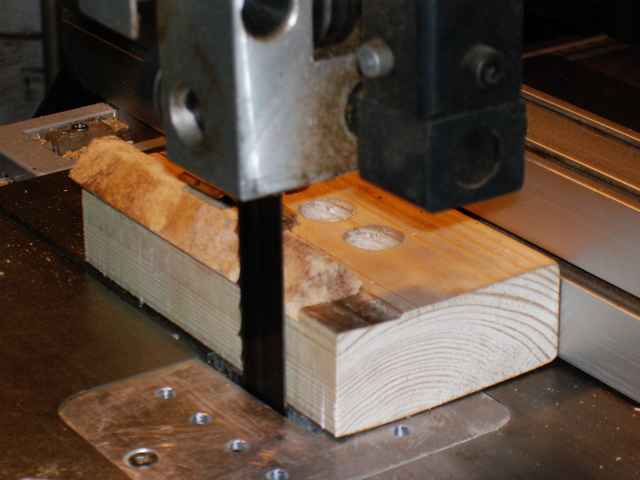

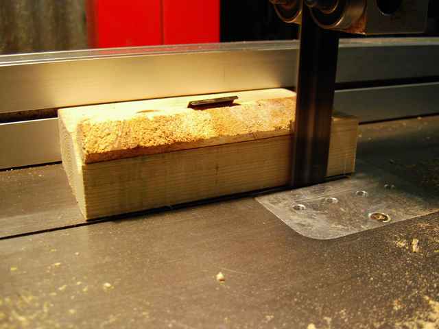

Hi John,
I think that I have put pics of my jig on this forum somewhere, maybe on someone else's post but I can show you what I've done for the pen blanks and it works really well, particularly the improved version on my first one. I cut (remove the square corners) a lot I mean, hundreds at the time sometimes, and it takes no time at all to do a few, just magic...!:wink::biggrin:
You should be able to work out how to do it, if not shoot any questions you have and I will try to help you through...!
Now..., where did I put those pics...???:confused::rolleyes::biggrin:
OK, found my original jig pics...! put these ones first and I will come back with the improved version...!:wink:
Cheers
George
