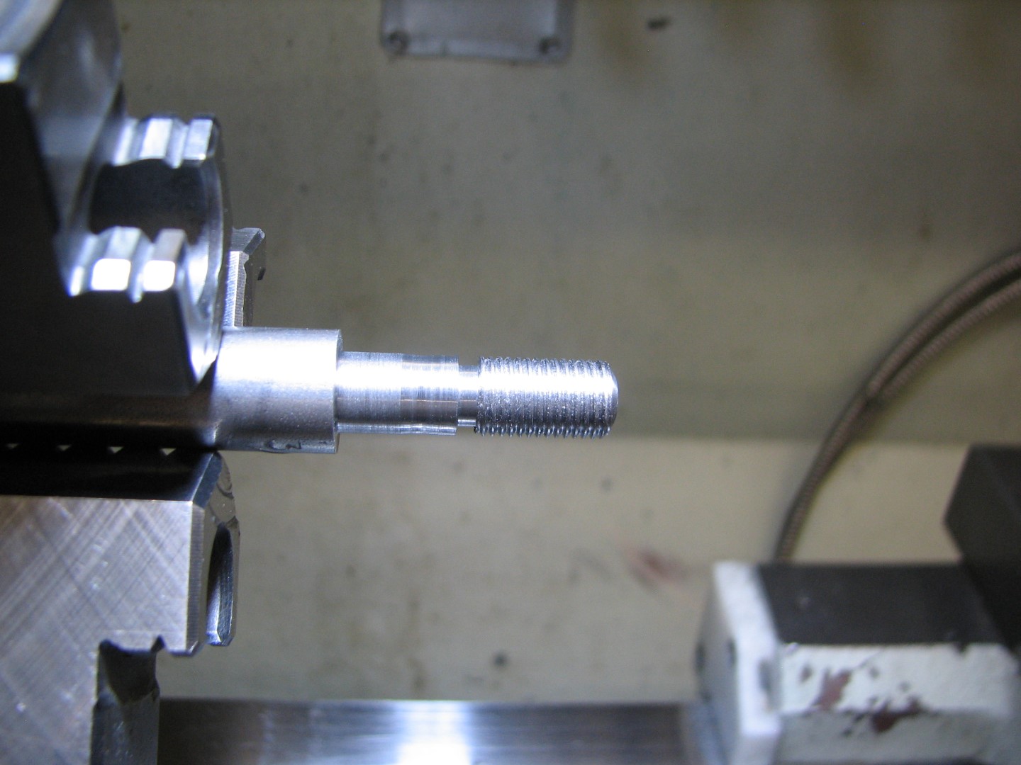

Then I made a threaded mandrel...
Next I drilled and tapped them all...

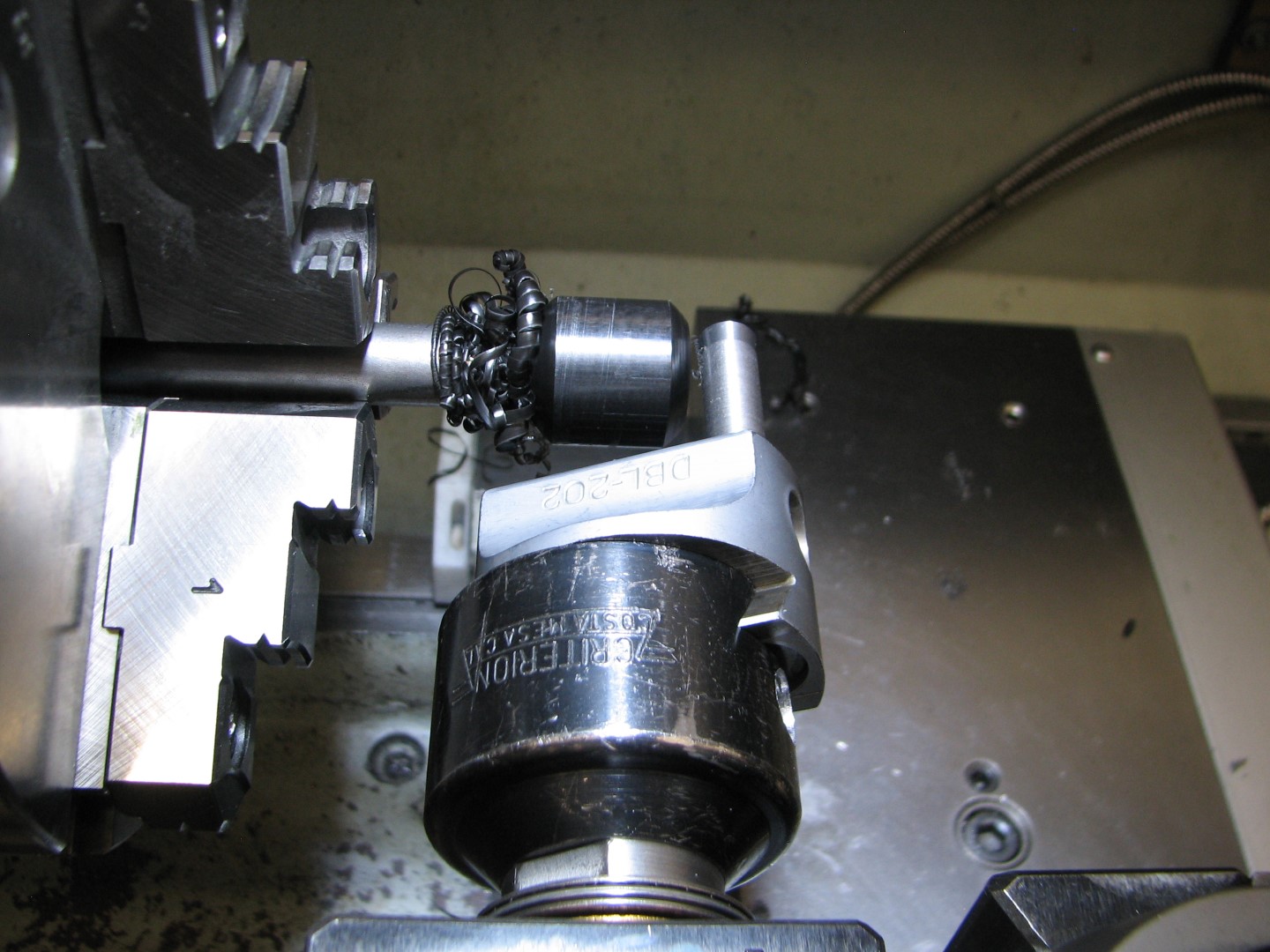

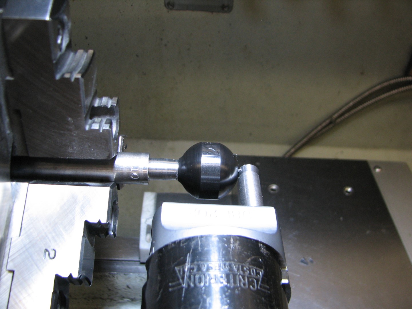

Then it was time to turn them using my shop made ball turner...
Finally I trimmed the bottoms...

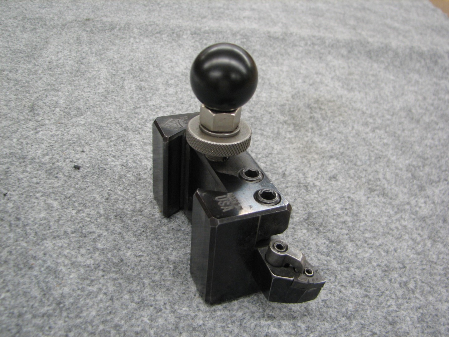

Here is a view of the bottom after trimming...

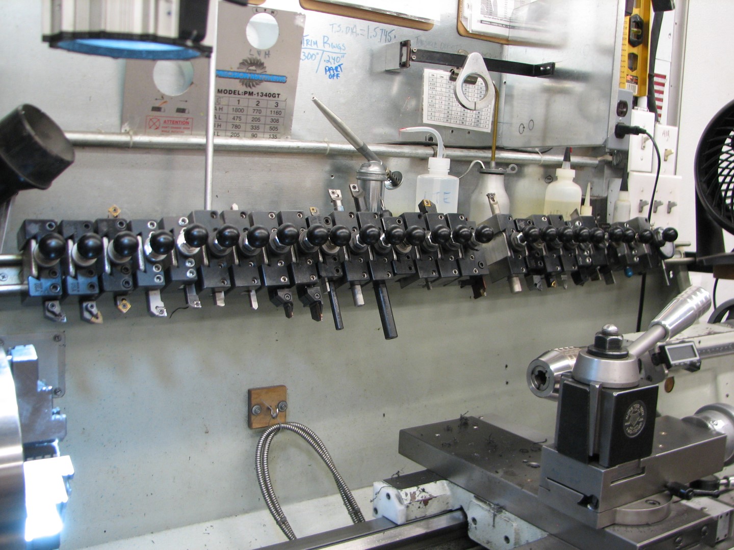

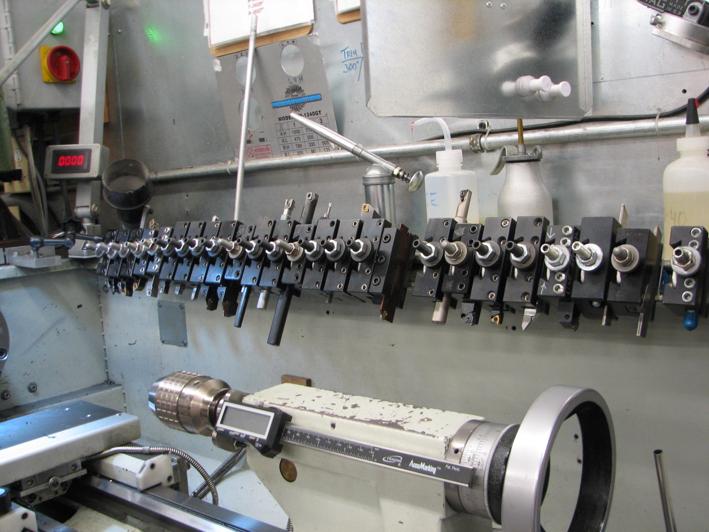

Finally, a before and after view of my tool rack...
Here's a close up before and after...

I've always wondered what I might use an adjustable boring head for, now I know - I reckon your ball-making jig could be adapted to fit a wood lathe tool post 😁
