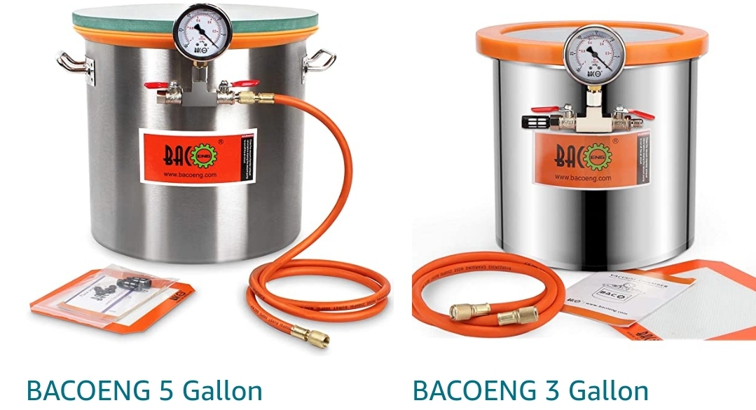

I'm looking at stabilizing equipment and need help finding a decent chamber, probably 5gal. I'm a little confused by the lid configurations. Here are two, 5gal & 3gal (pictured below). One the lid is sealed and one the lid has a seal underneath. What's the deal?
Ultimately, I need a recommendation or three about what to buy that is affordable and will get the job done. Here are two I'm looking at, for starters:
Problem solved. I think I'll go with this one. How do you decide 5gal over 3gal?
Buy the bigger one if its in your budget. You will have more space for individual containers. Be sure to buy one with a glass top. CJ is hard on acrylic.
