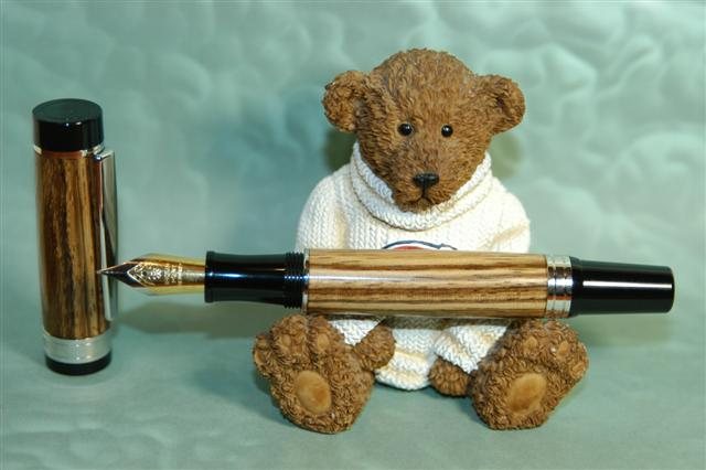

Here is one test i just did, looks like fabrics but it's an 8 1/2 x 11 sheet of paper. Forget the bear, i needed something to hold the pen fast as i did'nt use my regular setup for the test.
<br />
Hope this will help you
Alfred
Thanks Guys, I think I'm in over my head now. So many options so little time. Alfred your bear looks sad[:(]. Bob thats quite a selection Now I'll never know which one to use. Better make a trip to Staples and buy some new ink cartridges.
