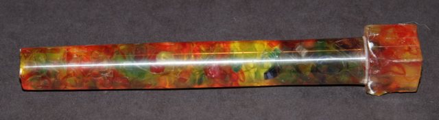

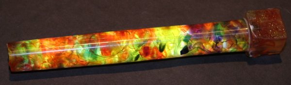

Ok, I just posted this in a casting thread but thought some folks might find it useful here too. If you have a really cool blank or pen that is semi transparent you can show it off really well by backlighting the blank.
Get a small fluorescent light and put a good diffuser over it. I used the diffuser from a kitchen fluorescent light. You can get them at Home Depot, Lowes, TAP Plastics, etc.
Now put a piece of black construction paper over the diffuser and cut a 1/4" or 3/8" wide by "blank long" slit in the construction paper.
Set your blank/pen onto the slit and start shooting. For me, I have to get the lighting by trial and error. Balancing the amount of flash with the amount of back light.
Here are two photos of the same blank with varying amounts of flash added to the backlight.
Happy shooting!
GK
