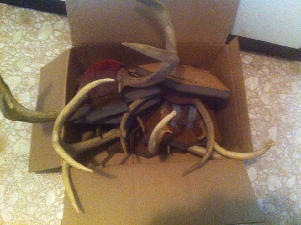

Awesome score on some antler
Skeels
Jul 8, 2016
83
Lincoln, De
Well i love turning antler. It looks great and sells great. So obviously I've been lookin for some cheap antler. I found some cheap blanks (like 3 bucks for one piece). Only problem with them is is one piece and only enough material for one blank. I don't like haveing my blanks not match up so I was pretty much limited on what I could buy. Well I scored pretty big yesterday. My mom hits me up sayin she's commin over to drop some crap off. My grandmother died recently and they're givin a lot of her stuff away so I figured it was stuff from her place... NOPE. Turns outta step dad gt "tired of lookin at them" and took all his mounts off the wall and told her to take then to my place. Box doesn't look like much but there's 5 sets of antlers in there. Needless to say, I'll be able to get a couple blanks from it lol. Some will have to be straightened but its all good bit I'm sure I can use every but of them
