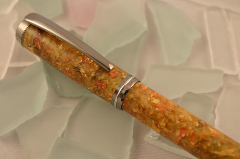

Jeff, I'm thinking this is not what you want, but I just did cast and turn some tri-color gold leaf from Michael's with a few drops of Amber transparent dye (Castin' Craft). I think it's very fall looking, but haven't fiddled with straight PR colors yet.

Hope you come up with something, share it if you do. And thanks, Michael! I did all of opening an envelope from Michael's and squirting a few drops of Amber in. But it did work, and I like it too. Thanks!

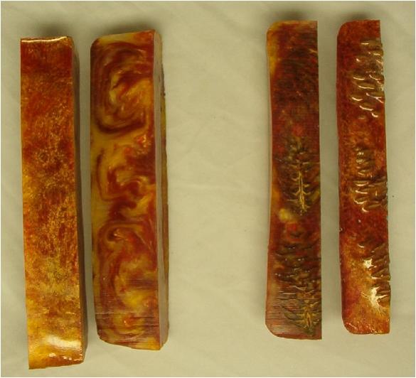

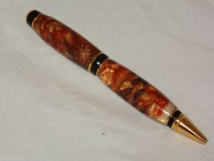

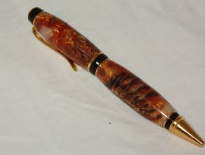

I would be very interested in hearing how you achieved the swirling colors around the pine cones. And do you stabilize the cones first, or just dry them and cast?
Colors are mixed individually, not all together. So you mix up a brown and you mix up a white. Once the colors are mixed, when you pour the two different colors into the mold basically at the same time, they swirl around and intermingle with one another creating a brown/white swirl...using those two colors just as an example of course.
Jeff,
The four main Pearl Ex Colors are: Interference Gold, Aztec Gold, Super Russet & Antique Bronze. Each of those colors has an opaque dye in it except Int. Gold. The tube was not painted. The darker brown color was actually the pine cone.
The pine cone acts as a diffuser for the separate colors. One secret to swirling is not to pour all of one color at a time. Break it up/layer it/cross pour it..... if your timing is close to gel time..... magic!
I can't recommend Pearl Ex "Mink" so far. It is a beautiful brown but seems to have over-tones of forest green interference in it. Kind of strange. I'll eventually find a good vehicle for it.
