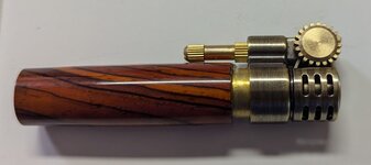

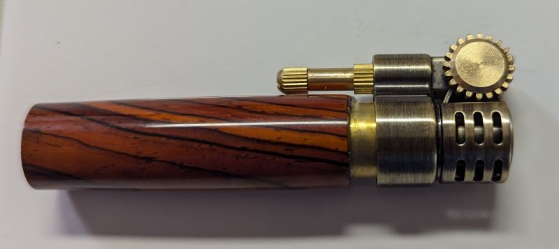

Arrgh... any suggestions on how to break out the tube from stuck CA
Darios
Oct 27, 2022
613
Vegas
I'm kinda thinking my thick CA is past shelf life - normally I get more than 5 seconds working time.
I suspect acetone will be my last resort.

If I have to, I will. I should amend my statement to say that acetone is my 2nd to last option. Just I'm rarely happy with my CA finishes and I'm happy with this one. It's a little off in the picture because I'd just pulled it out of the freezer because something something metal contracts more something.... but it is one of my better finishes.

I've been gluing 'em in as I turn them pretty close to the bushing size and I'm concerned with how delicate the shells are. It's also why this one got a CA finish.
I'd picked up her bushings for these on my last order but hadn't known about the sleeves though. I'll certainly be picking up a crop of them on the next order. I've been working with sanded down bushings from the rando pile to provide body support. Though I'm tracking on 12mm or 31/64 for the inner diameter of the shell.
Cocobolo with just a touch of sap wood. Probably one of the best grains patterns I have, er had, in house right now. Normally I'd just cry $%@!@ at let slip the scrapers of do-over, but .... fuuuuuuu..... this one is a bit harder to let go. :)

A little confused here. Went back to reread the post and you did not say how this happened. The blank looks turned down and finished so how is the tube not in it already? Please explain. My simple mind is working overtime here. :)

Turns out you weren't far off. Bench vise, not a hammer, but the 'big thunk' theory is the same.

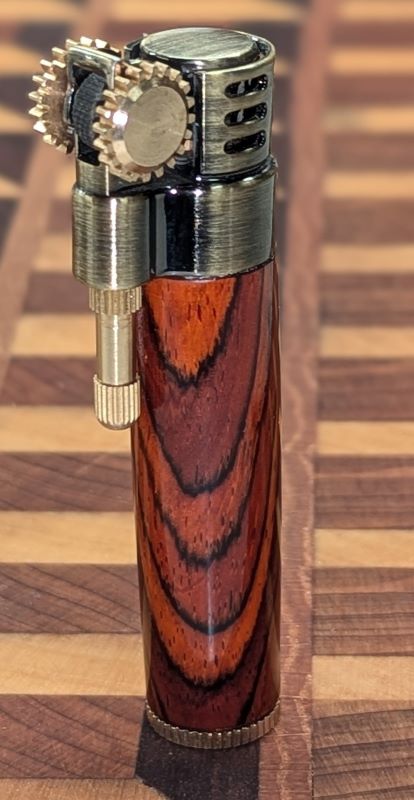

So, acetone ended up being my 3rd to the last option. (along with a fanatical devotion to the Pope). Popped it in a vise with padding to protect the top and a flat piece of metal to equalize the force on the bottom and with some very slow turns it ended up the CA gave up before the bottom of the shell did.
Maybe I didn't need to worry about how strong the shell was all along.
Still ended up with enough dings that I'm not comfortable selling it. The CA is still wedged in there and I can't get the shell off to repair it, but I won't be embarrassed to gift this one.
edit : @Mortalis - yeah, I'm normally on team epoxy all the time but I've gotten away with this specifically before with CA. Call this a lesson learned (again) on the high cost of taking the easy way.
Hi John, the tube on these is integral to the lighter and doesn't come off. The blanks are made and finished before they are put on the tube. - Dave
What Dave said. These are a single unit where you turn the blank into a shell and then slip it on to the lighter.
