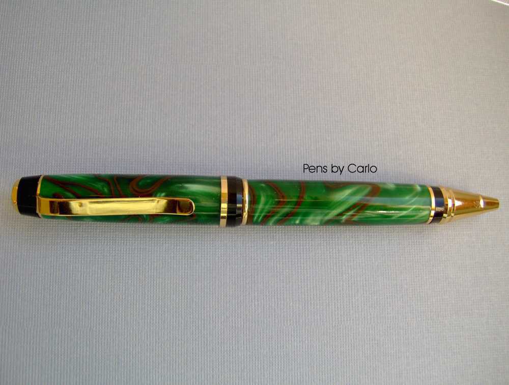

Hi,well i have been reading all the info above..Took this pic at window in daylight ,no flash with macro setting..I think it is the clearest i took to date.. Carl
That looks pretty good, except for the funky looking reflection near the tip. You should also crop out as much background as possible, so the pen occupies most of the space in the image.
