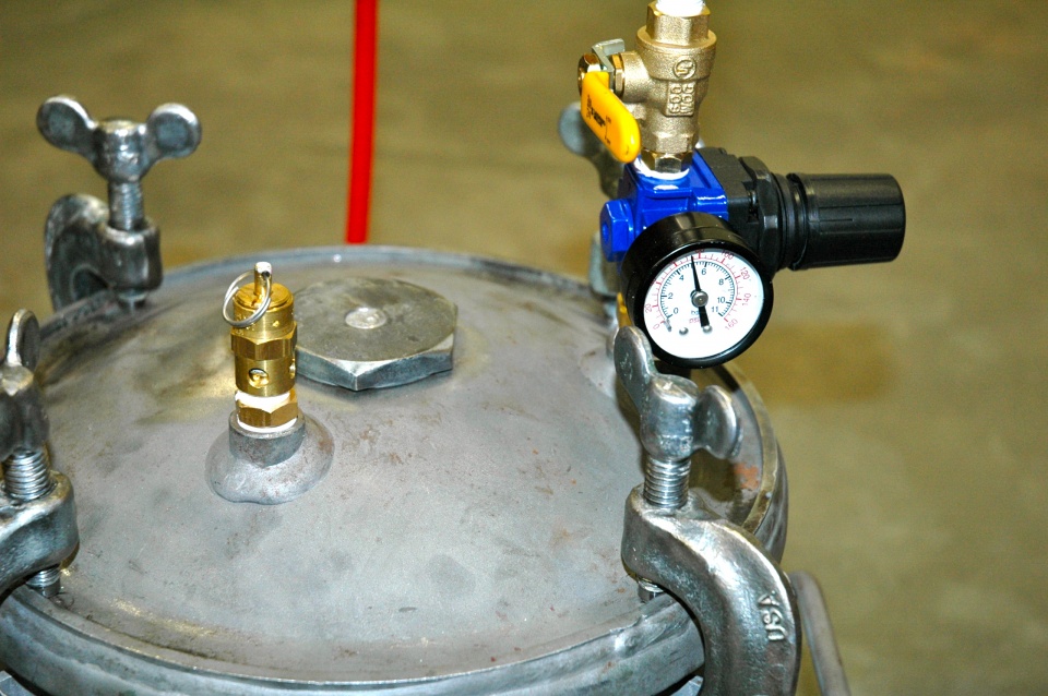

I almost purchased a HF pot but then thought better of it. I found a swinging deal on ebay for about $60.00. American made and built like a tank. Sure it was dirty and used but a quick sand blast and I was off to the races! I can run my pot at 80-90 psi all day long and never worry about a "ticking time bomb" in my shop:biggrin:. I put a 125psi safety relief valve in the extra hole for peace of mind and went to work!:glasses-cool:
Safety first my friend:smile:
