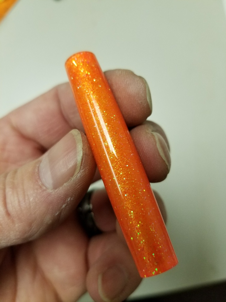

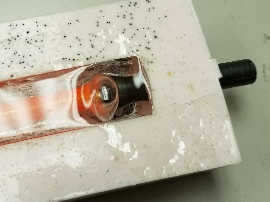

I am working on a in tube cast for the Tiny Giant Pen from Turners Warehouse. I used Liquid Diamond, which has a very long cure time. I was in too much of a hurry and took my pen blank out of the Pressure pot to soon. (should have left it in for at least 24 hours, I took it out in 12)
It was perfect when I took it out, no bubbles at all. After it sat for about an hour I looked a the blank and saw this:
Air trapped in the tube decided to make it;s way out now there was no pressure holding it in.
I think I can save the blank if I shave a bit off the end. Which leads me to my question, does anyone know about how much I can shave before it's too short and the pen sticks though to far? I don't want to assemble the pen only to find out the tube can't be cut down any.

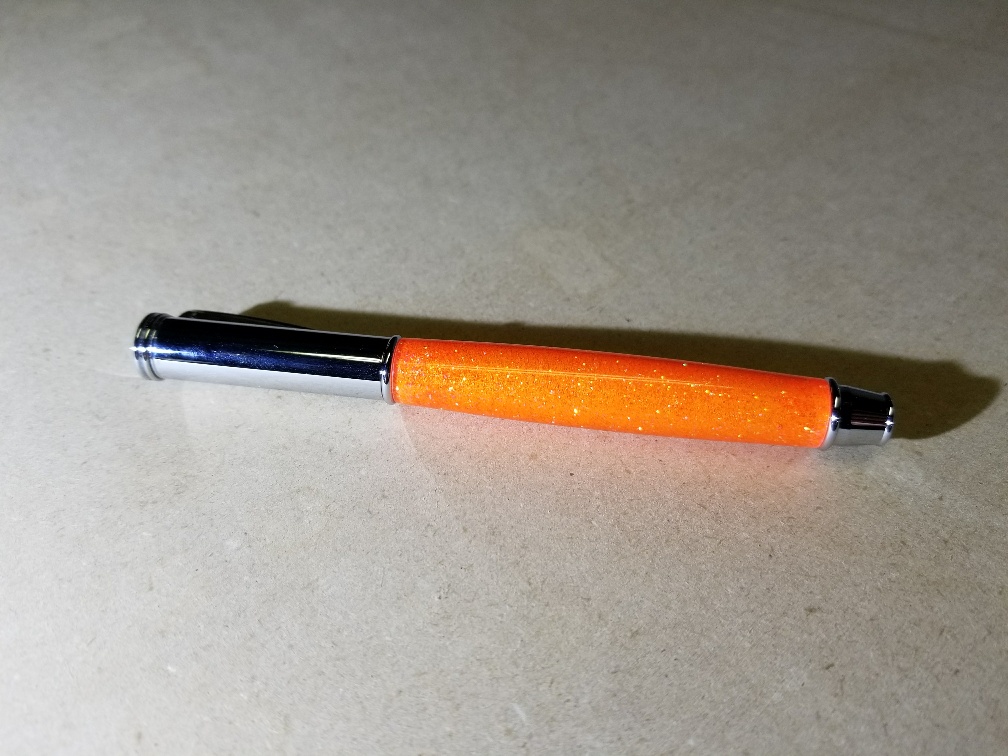

After examining the Tiny Giant, the ink cartridge rest against the inside of the back peice, so shortening the tube will result in the point sticking too far out past the nib and it won't look good. So, I think this blank is toast. I'll have to shorten it by almost 3/32" which will be way too much.
I will still turn it down however to see what it might have looked like. If I like it, I'll re-cast. I have extra tubes. ;)
I decided to cut 1/8" off the plastic back of the ink refill, can't really tell unless you set it next to another Tiny Giant. :)
Not one to sell or give away, but good for showing off ;)
