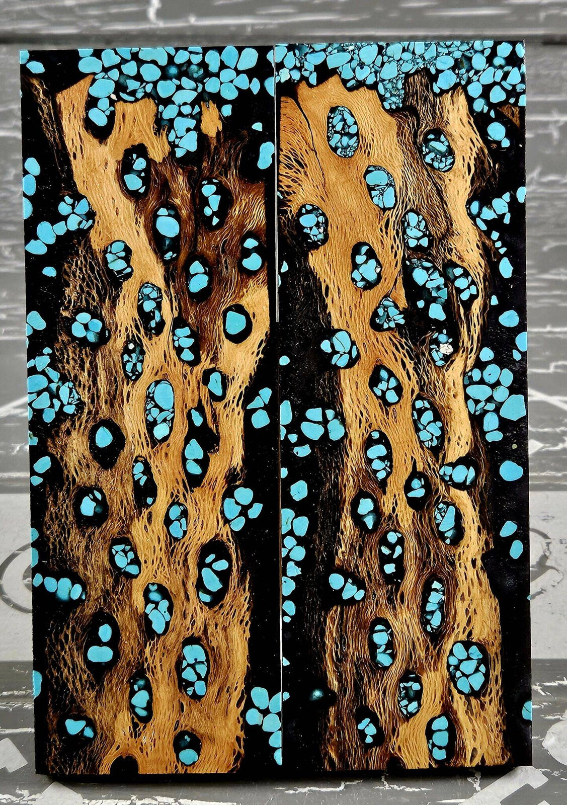

I had a customer send me these photos that are of knife scales he purchased, and wanted to know if I could make a pen blank with similar materials (Cholla cactus and crushed Turquoise). I guess I could get some crushed turquoise, mix it into some clear or black resin and pour it into the cactus, but I think that would be hit or miss if enough of the turquoise was visible in the finished blank.
Any suggestions?
Thanks.
The only way I could be sure of getting a pen with that appearance would be to cast it black without the turquoise , drill and glue tube/s in , turn nearly to desired size and shape , carefully grind out small holes in exposed black areas , medium or thick CA the turquoise into the holes , and proceed from there .
The thicker the pen wall , the greater the chance of success . I would not want to have any turquoise at the tube ends . A lot of work , but the final result could be striking .

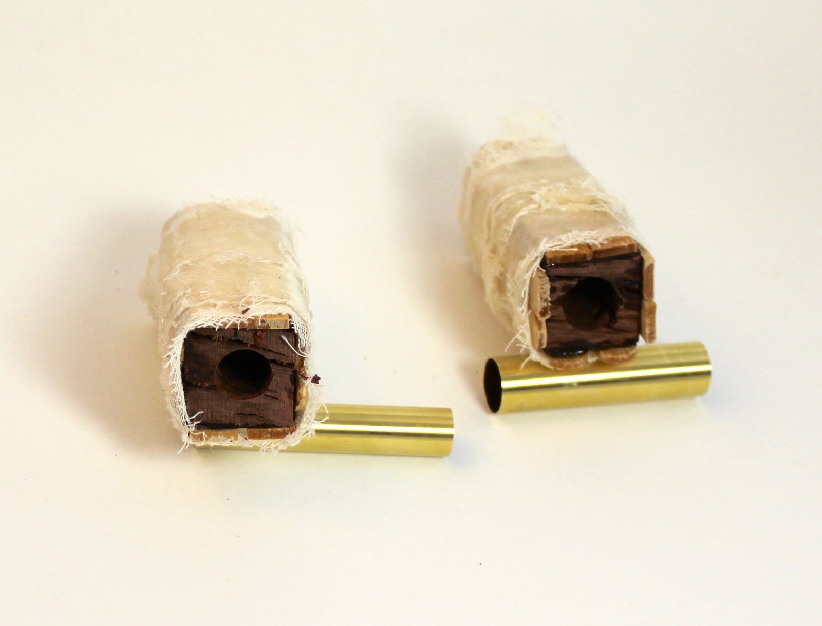

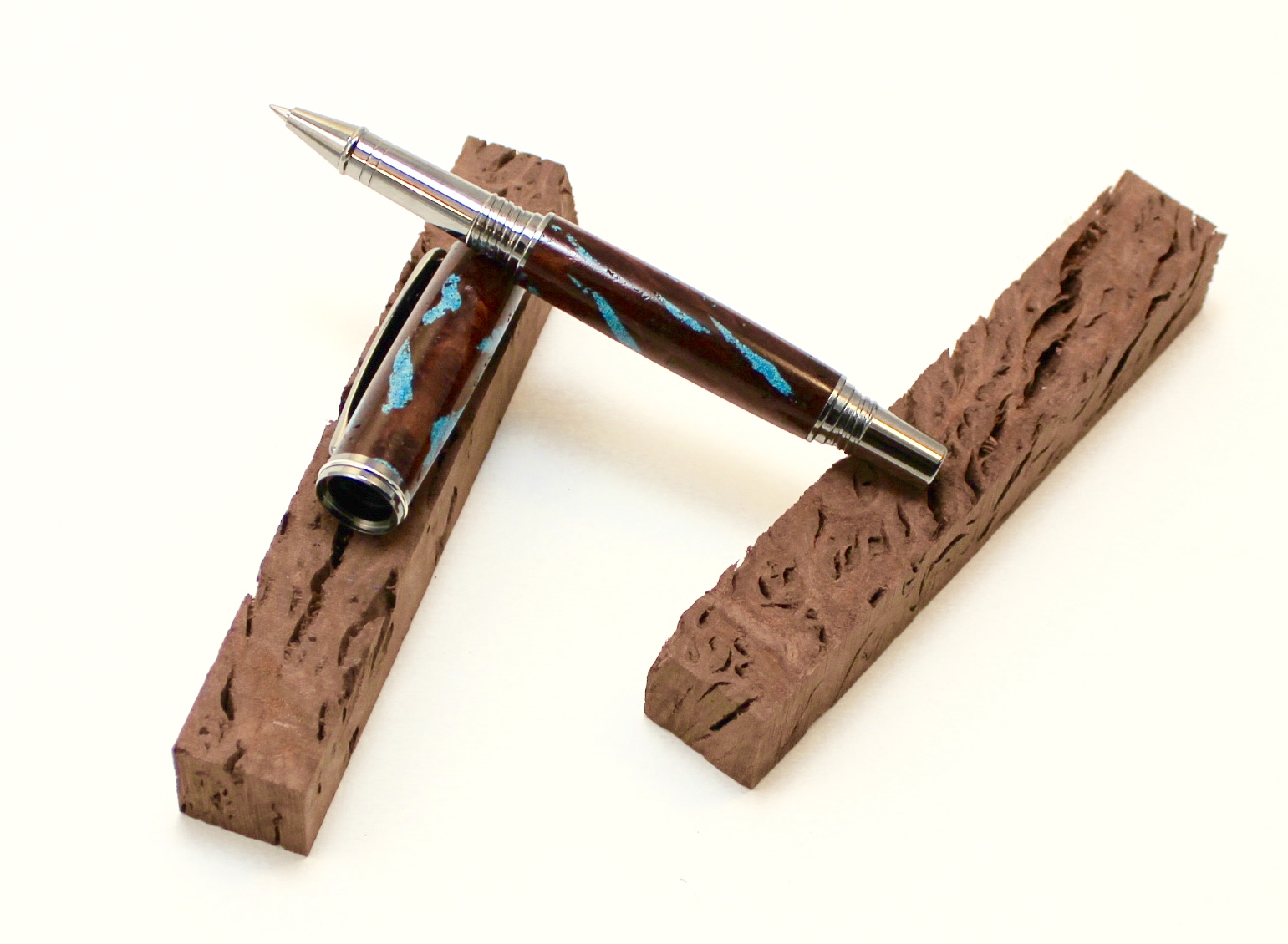

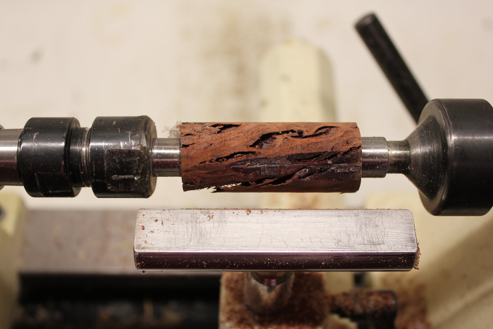

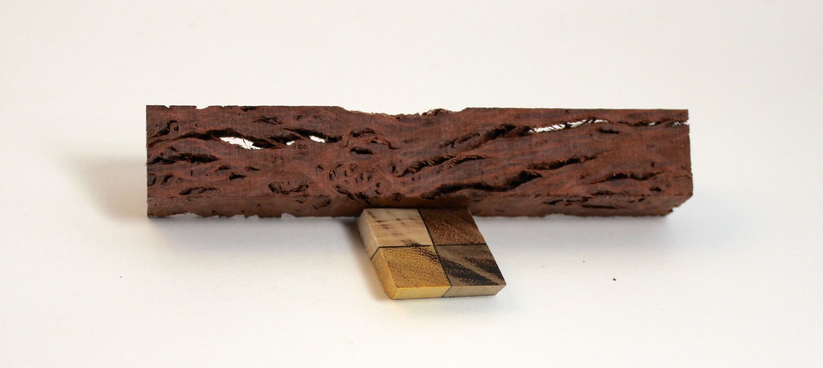

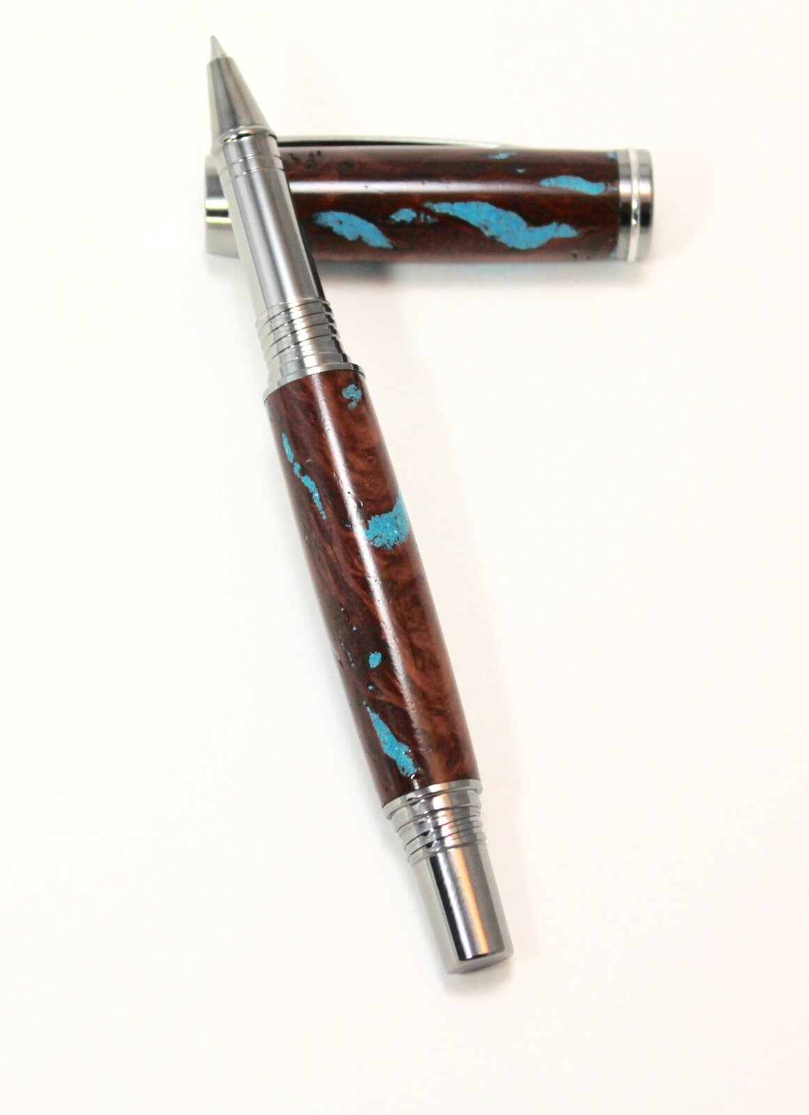

Many years ago I hand filled the gaps. I sifted the turquoise sand in several tea holders to get very fine grains that would seep easier into the cavaties. I sifted the sand in and dripped CA over the top. It actually went quicker than I had anticipated. Drilling and turning was the real concern. I forgot the name of these blanks, but they were not stabilized, so it made for several 'exciting' possibilities, but all went well. We still have and use this pen.
