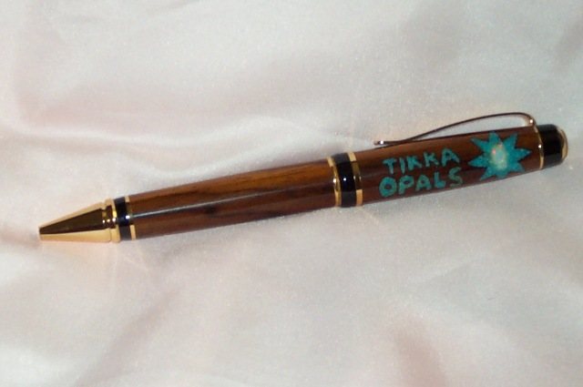

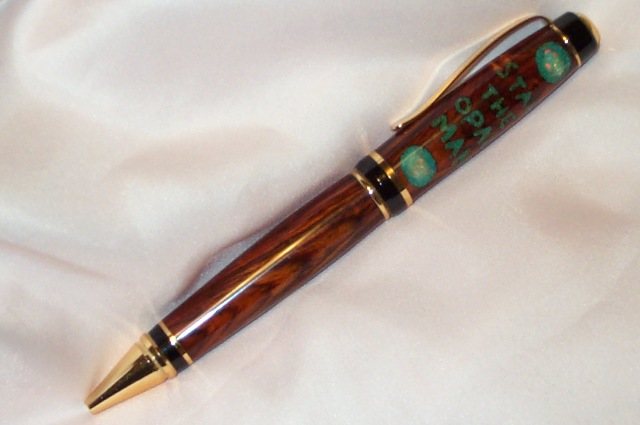

Hi, I have done several custom orders lately with inlaying business names. I printed the name out using Word, taped it to the wood after it has been turned, used a Dremel with dental bits and traced it out. After that you just fill it with whatever you are inlaying, put your finish on ( I would recommend CA ) assemble and walah [:D] Hope this helps.

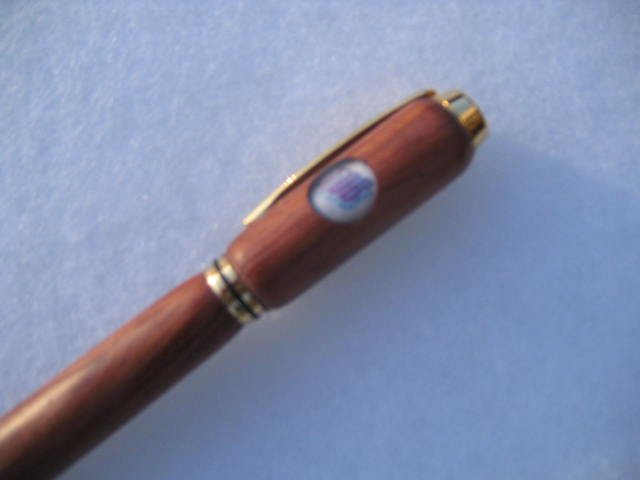

This is what I have some what perfected for what you are trying to do. I cross drill a 1/2 forstner hole into the tube hole. Place a mailing label with the initial you want on the tube, CA glue the tube in the hole using caution not to get glue on the initial because it is rough when dry. After the tube dries use thin CA glue over the initial so the poly does not take the glue off the label. Fill the hole with poly and let dry and turn and finish. Actually I am using liguid ice but I think clear poly would work.
