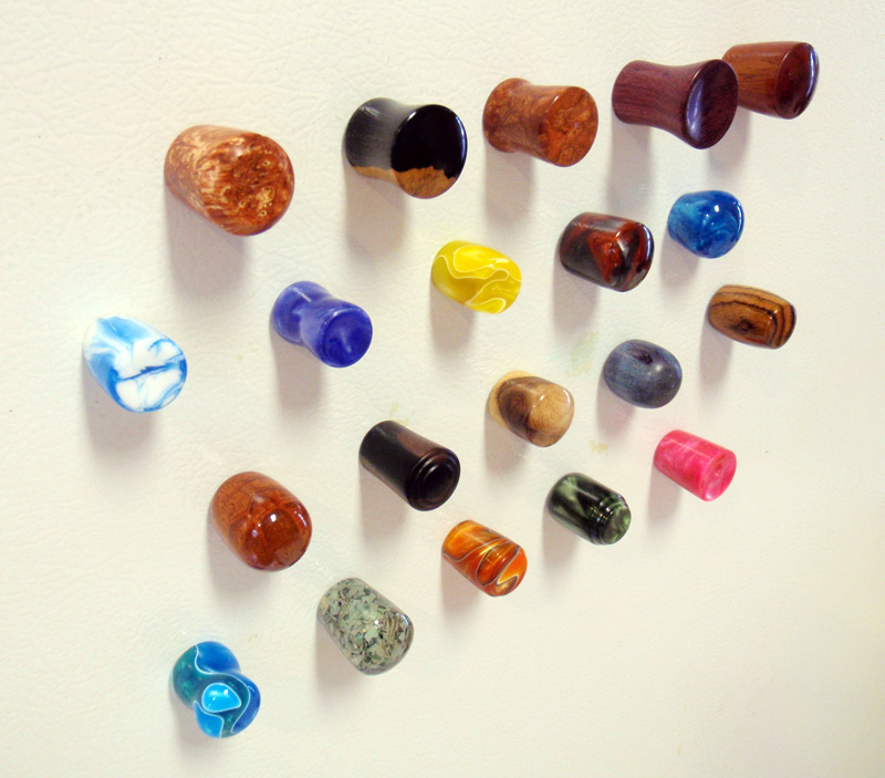

Not a kit, but here are some I made:
http://www.penturners.org/forum/showthread.php?t=52824
and here's the how to:
http://content.penturners.org/articles/2009/fridgemagnets.pdf

Wow,your fridge magnets look great!
Thanks for the how-too link,I just got a printer so I tried it out on that.I look forward to learning this new project.
