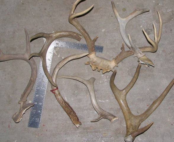

I have some you can have. It is mostly smaller antlers and some parts. I live in the Carrollton area and work in N. Dallas (Midway close to LBJ). I'm not sure how much you need but you are welcome to it. It is mostly whitetail and very dry. PM me or reply here and I will take a photo and post it.
Wow, you can't beat a deal like this, I'd love to see what you've got.

Here is what I have.
