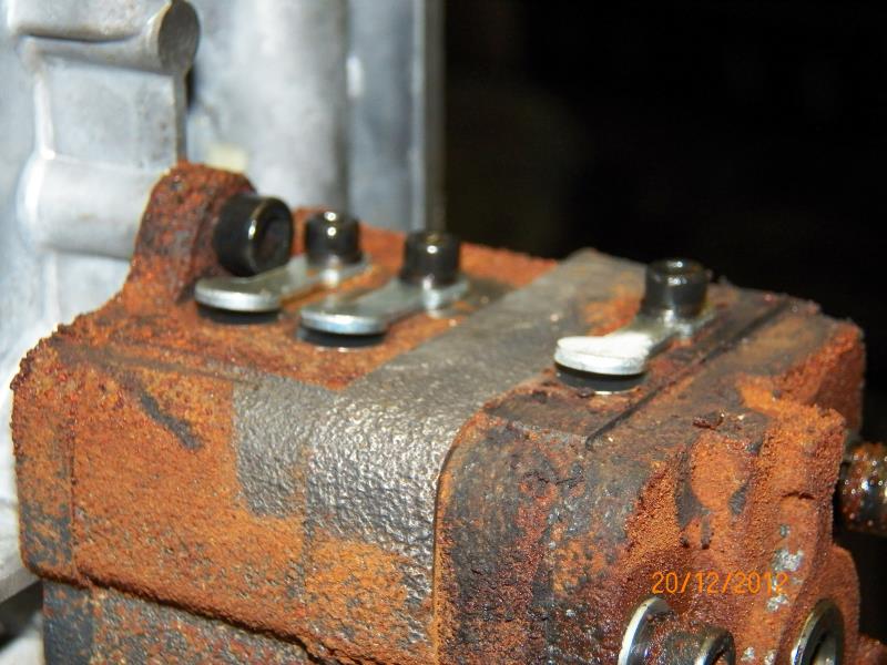

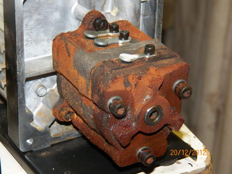

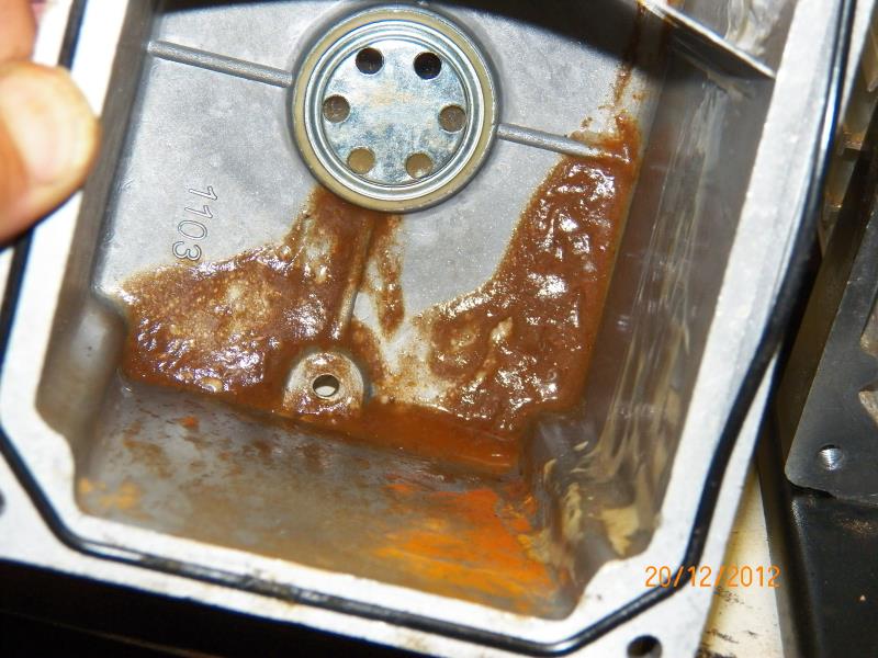

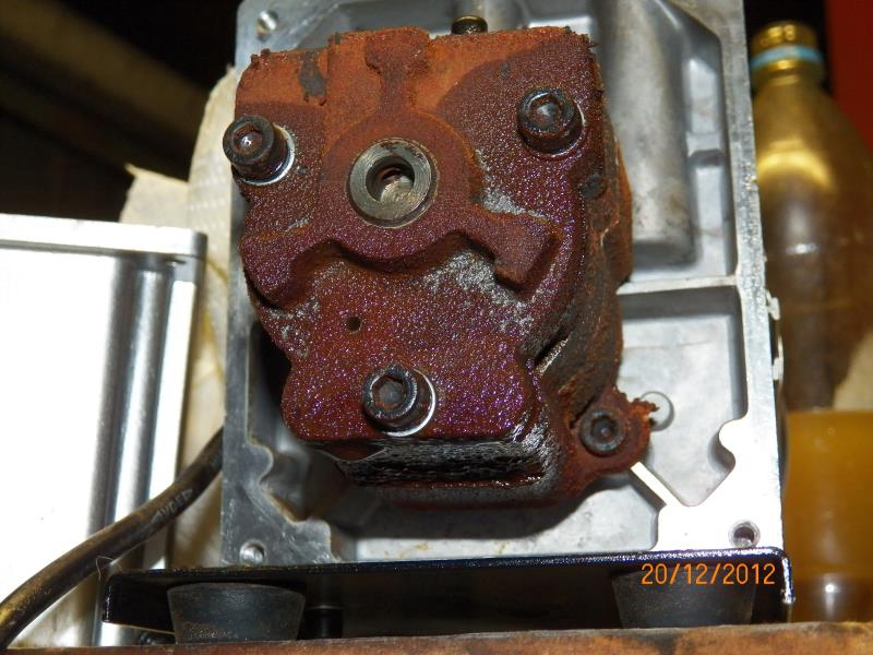

004.JPG Drain the oil and remove the sump reservoir/cover, 4 hex bolts hold it together with a round O'ring as the gasket. This is a easy process and does not affect the pump in any way. There will be lots of gunk at the cover bottom, that you can now access easily and wash it all with petrol, 013.JPG the glass oil level window is now a lot easier to reach, the perforated metal cover is fixed/glue on the inside but, you can easily clean the glass (I use the air washing gun with some petrol in it).
You will also see some surface rust from the water, and a bit of dirt on the valve(s) housing that is now exposed, 012 (2).JPG 017.JPG 019.JPGyou don't have to dismantle anything, you simple clean all that the best way you can and then put the cover back in.

George, how old is your vacuum pump? It looks terrible inside with all that rust. It shouldn't hurt the operation of the pump but boy does it look yucky.

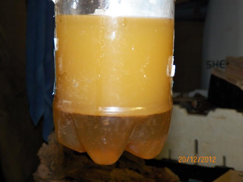

The pics are from my first oil sump removal and after the first 6 months of stabilizing gallon after gallon, I never had/worked with a vacuum pump before, I wasn't sure how often the oil should be changed (was clear oil, originally) and most importantly, I had no idea of how much moisture these pumps suck 016 (2).JPG so, I kept wondering why the oil level would go up and not down, to be point where, on releasing the vacuum, my primary filter (I had 2 at the time) would get full of oil...! 001.JPG
All that rust was created from the amount of water set on the oil sump for some time, the surface rust was easy to remove, even easier with my mini sand blaster, I don't think that I took pics of it after cleaned (I should have, tough..!:mad:) but, it would never cause much damage as oil was running over all surfaces when working.
The sediment/gunk seen inside the sump, is a combination of various things, the water staying that for that long, was one of the bigger ones...!
The pump itself was rinsed with some degreaser and the motor turned on for about 10 seconds or less, that was enough to let the degreaser run though the system and wash out any gunk from the inside but, it come out fairly clean, all gunk was in the sump's bottom.
