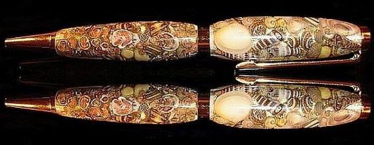

I attach the shells to the brass tubes. Each piece then cast in clear. I'll try and find a pic but it does take time ect to make them but people love them and they do look nice
Ok, found one. I did this one several years ago and improved on them but you can get the idea. Regular HSS tools work just fine
