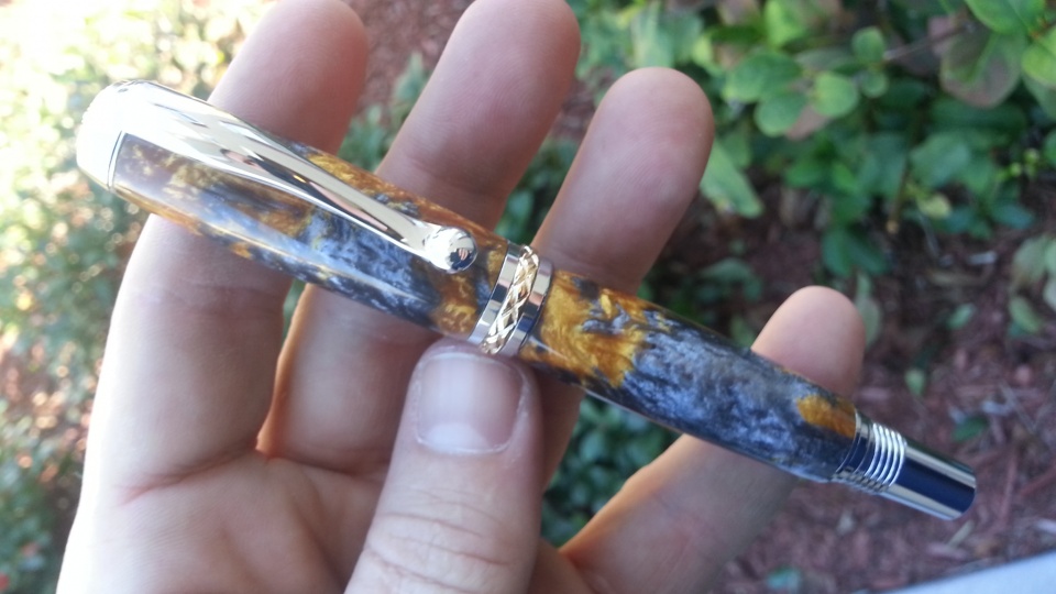

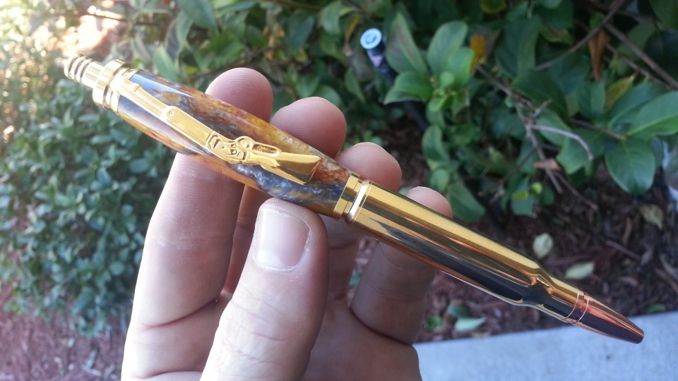

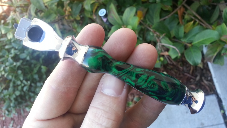

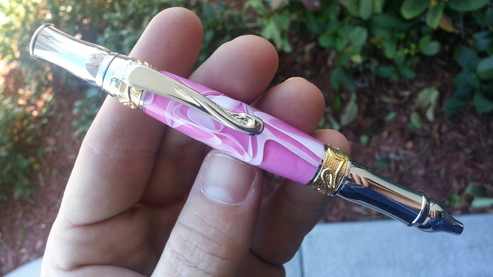

Had another great day in the garage. It was a beautiful day after it warmed up a bit and I got these turned for family members.
- Used the rest of my razor blank from yesterday for a Broadwell Sceptre painted in pink.
- A bullet click in a molten medal I think (had this half blank for a couple of years).
- Another razor in homebrew green/black alumilite.

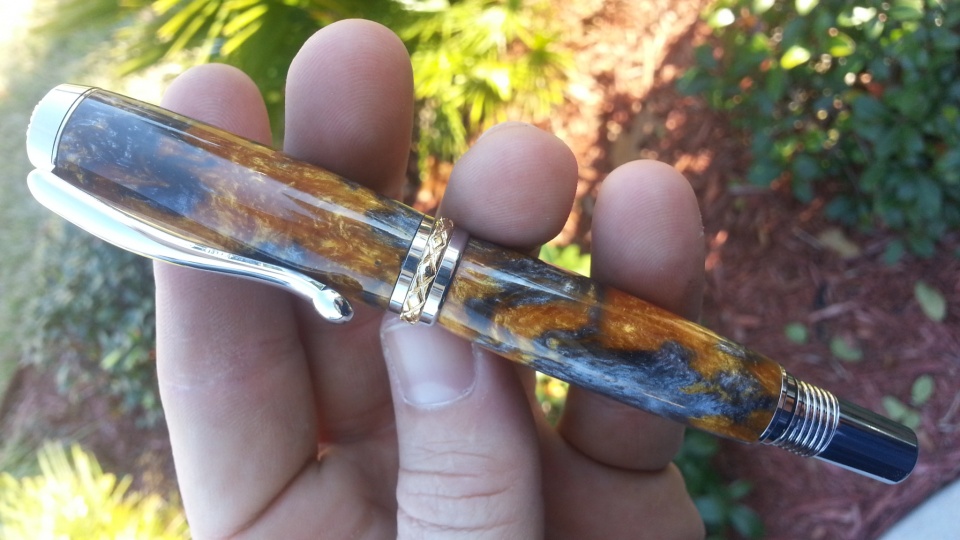

- My Eleanor, homebrew antique gold/antique silver alumilite Triton RB. I've tried several times to make this pen. I've had reverse pain chip off, cracked the blank, or seems something always goes wrong. I think I got it right this time, finally!!!

Would love to see some more pics of the triton...but then again..like to see some more of em all:biggrin:
Here's another pic I had taken that day.
What was the finish? MM'd to 12k and polished or something different? I really like the looks of the triton and would like to know more about the blank..:wink:..those may be the words of my 3 daughters and my wife...I have to quit looking at pics with them looking over my shoulder..but then again they have awesome taste:biggrin:
When turned down, this blank had a few pen holes, so after sanding with 400x, I did a CA finish (2 coats of thin, 6 medium, 2 more thin), sanded with 320x, 400x, and 600x. I then buffed with Tripoli and then white diamond. That's the finish. The blank itself is alumilite clear with Aztec gold and antique silver pearlex powder poured into a ptownsubbie vertical mold and put under 50 psi in my pressure pot. I hope that answers your questions and thanks for all of kind words.
