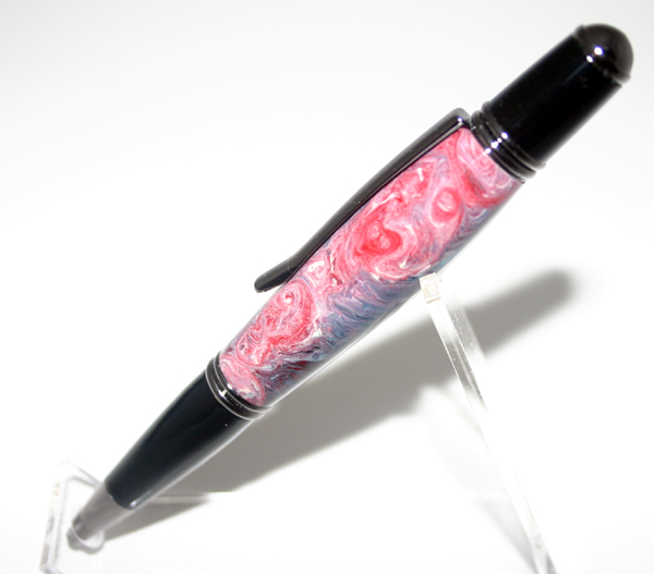

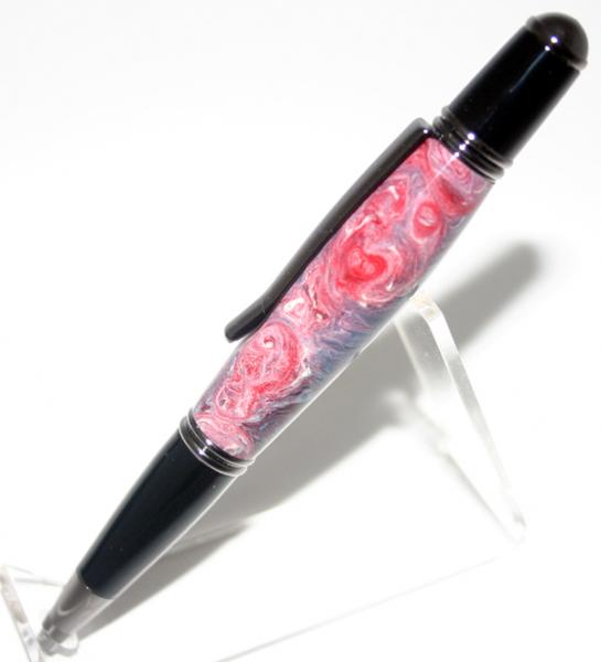

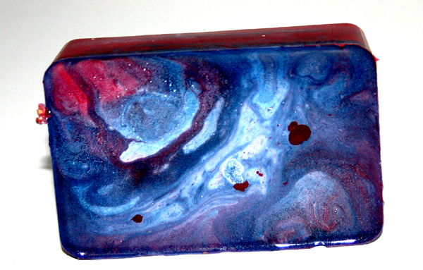

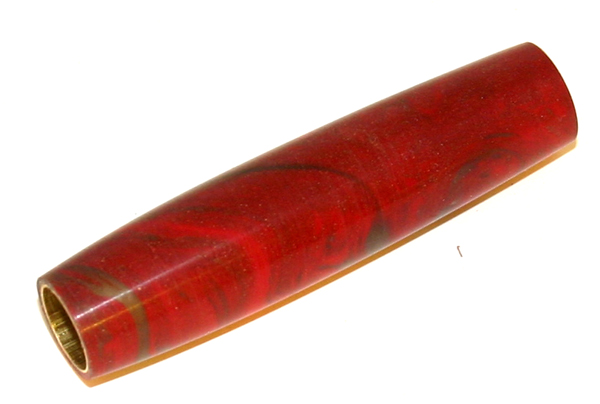

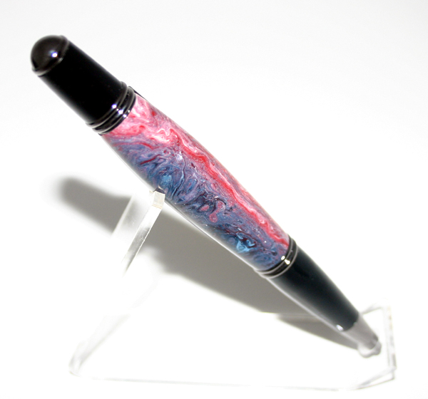

Okay - so to start with how this experiment started. I was rummaging through some boxes the other day and found a bin full of my old modeling stuff (cars, planes, etc). And of course in that was a bunch of the model enamels - 10 years old or better, but if shaken enough they would be pretty much normal again - so of course one thing led to another :rolleyes:

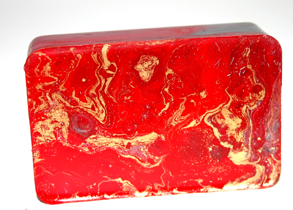

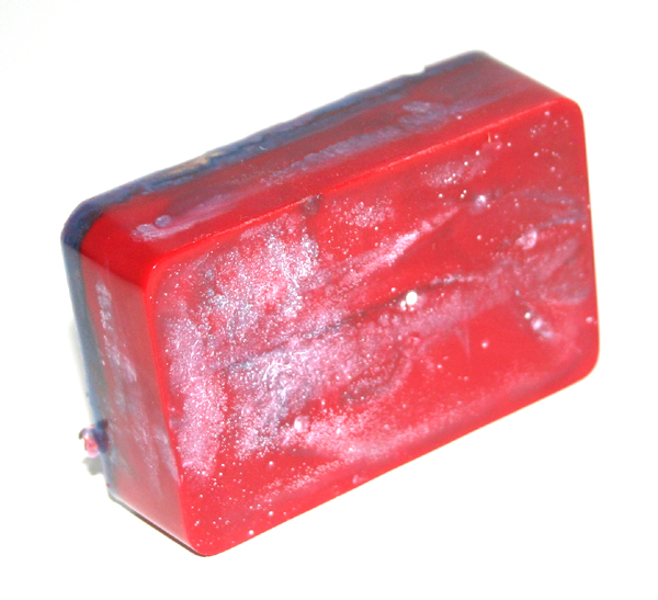

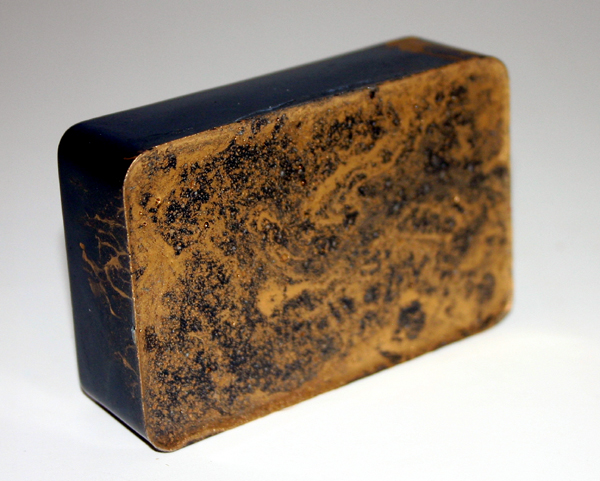

I had cast 3 molds. The first was to be called "Golden Night Sky" - blue metallic mixed with gold. The second was to be called "Nucleo del Sol" (Core of the Sun). These two molds ended up being failures - not because of something I did, but something that the Resin from Michaels can't do with the enamel paint - HARDEN! I let it set up for 4 hours and then placed in my toaster oven at 125 for one hour. Like a rubber band (well okay, a tire). It is possible to turn, but I blew out both of the blue/gold ones so I am going to try the Core of the Sun one here in a little bit.

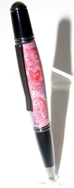

That being said - the third mold was made from the Resin I got from PSI - and I call the mold "Proud to be an American!". It is a standard gloss red and gloss white and a metallic blue. The mold came out hard and drilled like I expect acrylic to drill (not like drilling pine).
Beautiful results in my opinion - especially for my first successful mold out of over a quart of resin :redface:
I did include pictures of the other molds, but the primary attraction of course is the red/white/blue :biggrin:

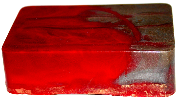

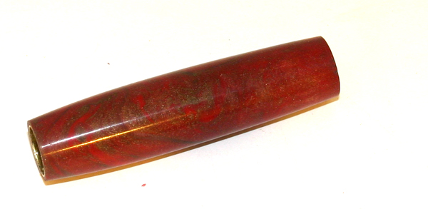

Nucleo Del Sol

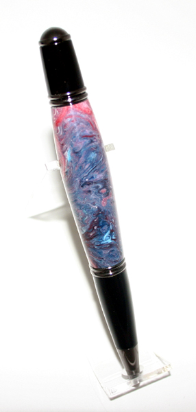

Okay - so my Nucleo Del Sol mold was a bit of a disappointment. As I said it is a bit rubbery - but I figured I would give it a shot. It was a lot better than my Golden Night Sky mold - but still disappointing. The elasticity was just too much and I guess I didn't put enough CA glue so it didn't turn round, but weird like. Either way I took pictures of a turned one just to show.
I am willing to mail the other half of the mold out to anyone who wants it, I don't plan on turning it. Just PM me an address. If no-one wants it I will throw it in my dud pile, but I am warning everyone beforehand, it is not "solid" it has flex to it.
Edit: Mike (msvoma44) requested the leftover blank - hopefully he can make something happen with it.

Wonderful! I'd really like to see the red white and blue on a better kit, show it off a bit more!
The red is the bomb! But ruby is by far my favorite color.
Unfortunately I am running low on kits - I have various slimlines, gatsbys and vertex kits left. Need to get another order in soon :wink:
