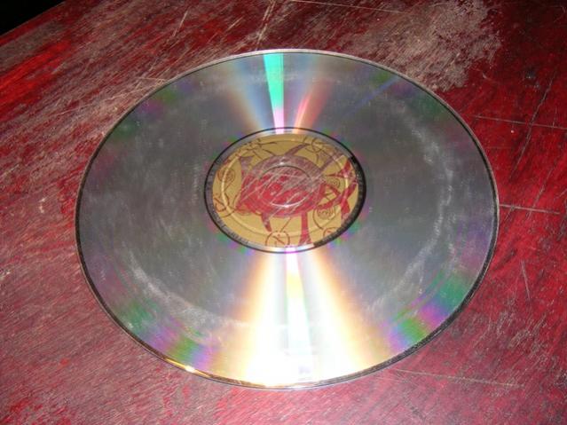

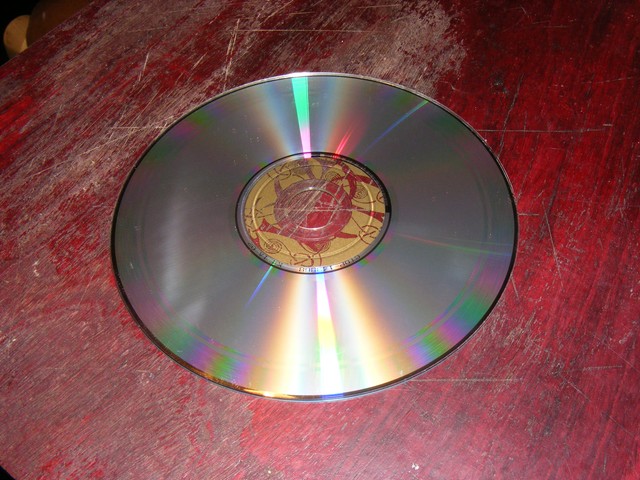

Here's an example.
Not the worst example I've done, but the one I took pics of. One track on the disc wouldn't play before.
