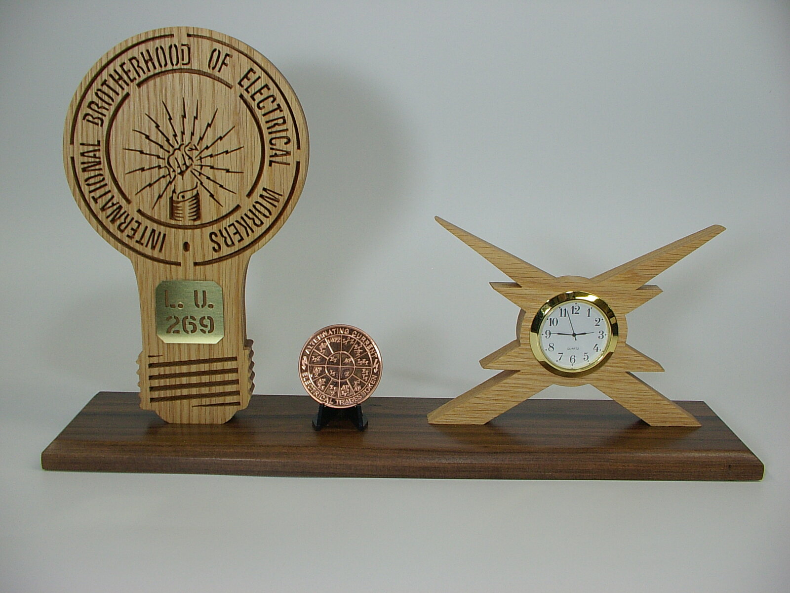

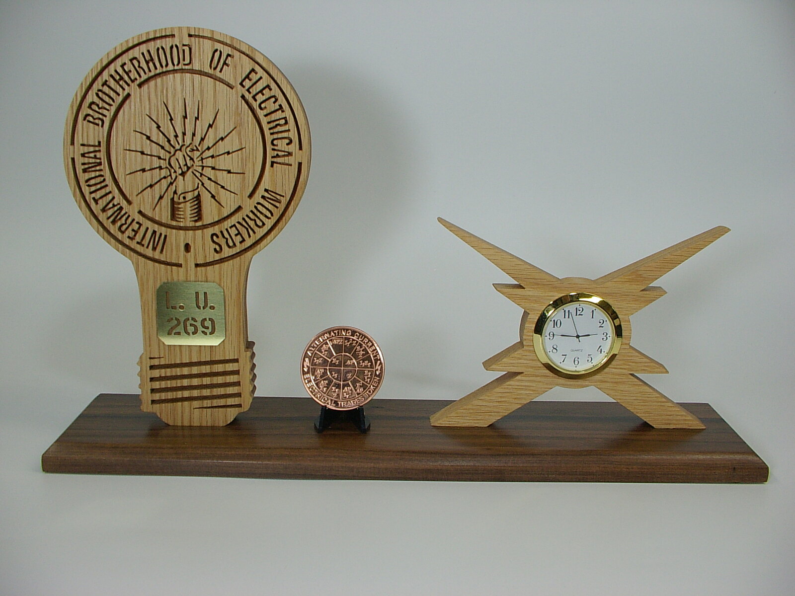

Larry I will say one more thing, patience is a key element. I have plenty because I grew up with scrollsawing and that will test your patience for sure. But also a light touch. I have large hands and find myself using tweesers, awls, or popsicle sticks honed down to points. I did pick up a huge trick just recently from jewlery makers and that is there is wax sticks that they use to pick up small stones and pieces. Talk about a life changer for me and watch part pens. One of those why did I not think of that. Also and again a huge one, lighting and possible magnifiers. Again as I got older they rose to the top of needs when doing scrollsaw work as well as anything intricate as building watch part pens. Good luck. Here is an example of scrollsaw work that I would not be able to do without magnifier and also good lighting. My own pattern but the cutting of letters is time consuming and I could show you plenty more.
