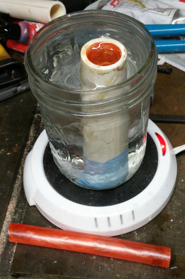

Ok here is what I'm trying.
The candle warmer is a tad harsh and on even for heat. So after I poured my blank, after using the warmer to pre warm my resin. Did this started with hot water and after less than an hour it's pretty well set. The water helps distribute the heat. I'll check to see how hot it gets after an hour or so.
I put an old glove finger over the masking tape to water proof it.

Oh and my blanks did harden. I've been out every night and last night was the first time I could get at them.
No bubbles and perfect hardness.
