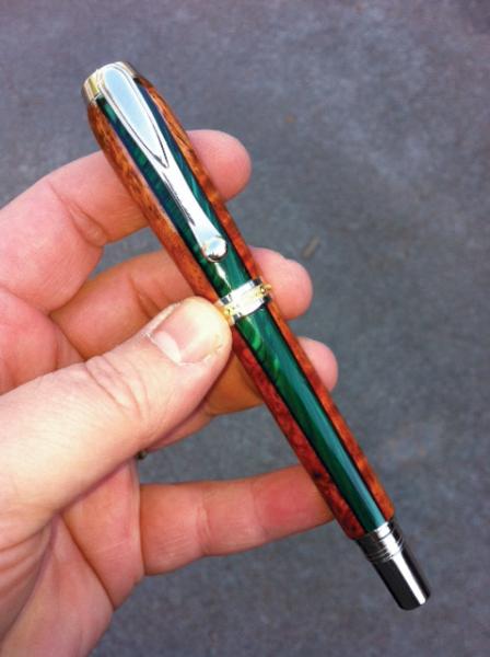

Sorry for the crappy photography. I just thought I'd show you guys what I've been up to lately. I knocked this out in about three hours...
I took a long wedge of malachite truestone and CA'd each side of it with some black plastic sheeting I bought at a modeling shop (used in building architectural models). Then I cut an amboyna burl blank lengthwise and CA'd it to each side and clamped it up.
To make sure the malachite was centered on the finished pen, I found the center of the truestone on each end, turned the blank round, then I cut it and drilled the blanks on the lathe.
For finishing, I sandpapered up to 600 dry, then used two thick coats of medium CA glue applied with a plastic baggie on my finger. There was 8 hours between coats, and I did some light sanding with 600 between coats to smooth everything out.
Then I used wet 600 and the MM pads. Because there were still micro-scratches in the CA finish, I used all my sports car stuff to finish it off, believe it or not. I've had great success with using a plastic polish for wood dashboards and the plastic window on the back of my convertible top (btw, it's MUCH cheaper than the stuff we buy for pens too!) followed by two coats of Klasse All In One acrylic sealant (filled in all the scratches and further protected the CA finish) and finished it off with a quick swipe of carnauba wax to add even more wet shine to it.
NOTE: This is one of those pens that I made for someone and I do not want to give away. It turned out so nicely! I shall enjoy it until Monday though, when I have to drive it over to my Dad and give it to him so he can send it to his best friend as a Christmas gift. :(

Very nice. Is it clipless or is the clip on the other side? Just curious. If you get a chance, I'd like to see how it looks with the cap posted... and is that a fountain or rollerball? Details, need details!

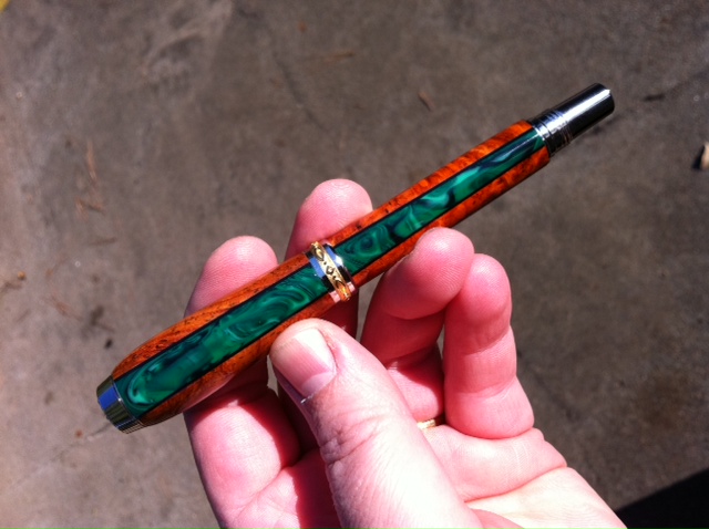

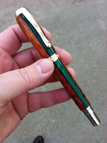

Here's two more crappy photos showing the front of the pen. I'm so lazy! I was a professional photographer for six years! Sorry about that.
Thanks for all the cudos, but very VERY little planning went into this pen. I just thought a straight band of malachite would be boring so I cut a piece of scrap at a slight angle, set it in my table saw sled, slapped the malachite blank in there, and sawed off part of it and build the blank outward from the left and right sides.
The dark reddish color of the wood against that dark green is absolutely my favorite color combination. BTW, this color combination looks great on cars too. Dark green paint with a tan leather interior. Mmmmmm :banana:
BTW, this is a rhodium and titanium Jr. Statesman rollerball.

Randall - Your drilling on that one is spot on. That in itself says a heck of a lot. The combination looks good and I really like what you did with the shape. Now how did you decide whether to put the clip over the wood or the Tru-Stone?
