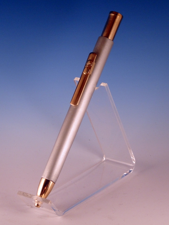

Anodized aluminum barrel with bronze clip, nose cone and click button. Even machined the little screws to hold on the clip. Come see how easy it is to make these at the MAPG.

Bruce, the pen looks great. I'm not sure if I'm more impressed that you machined the screws or were able to install them without marring the crap out of them:eek:

I actually made a little wrench for them out of brass with a small grinding wheel and Dremel tool, but after I tightened them up took the pen to a fine wheel on the bench grinder and rounded off the tops.

Are your screws actually pins with screw heads or did you make proper threaded parts?

Thanks Skip - For the screws I started with round stock, turned some down, cut the threads (3mm x .6 I think), then milled the hex head.

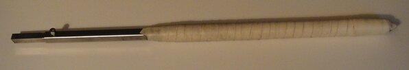

The bronze I have is very easy to turn, both with hand tools as well as on the metal lathe. The nose cone was all by hand with a home-made tool. I use 10% cobalt steel tooling normally used in a metal lathe, but just hold it in a piece of square pipe with a set screw and a little foam tape around the handle for comfort.

Here's a pic of my new tool...
