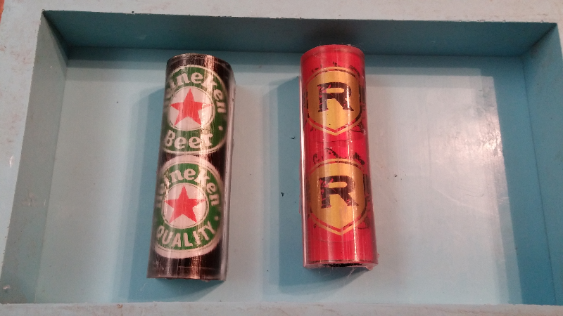

Ok third attempt with alumilite I warmed the mold up and this is the result. I was about ready to give up on alumilite but now I think I have it down. I really like the way alumilite cures.
