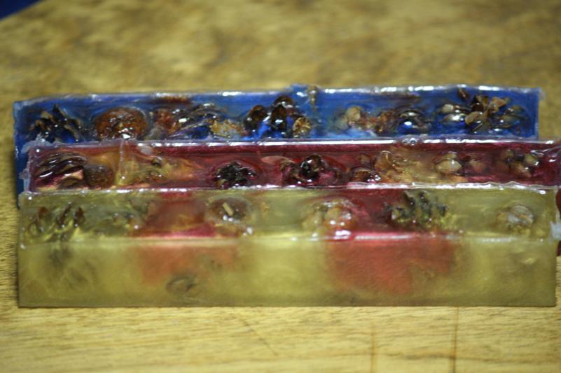

Sorry, I'll try to clarify. The blanks contain hemlock cones, acorn caps and beechnut husks randomly arranged in the mold. At this time I am pouring individual 7/8" blanks but may change to a slab pour. Going back over some past posts I guess I need to wait a bit before pouring but since there are a lot of voids to fill I am worried about trapped air even though I am using a pressure pot.
I've attached a quick photo of some of the blanks.

why not make the swirls, then embed the items? use an over sized moldfor over flow and a thin wire to push them in.
My feeling is that way would trap a lot of air around the cones especially and with the short set time for alumilite I'd be nervous about getting the objects submerged in time. I'll maybe give it a try with one blank and see how it works.
Michael
Perhaps try pouring slower from both colors at the same time?
Put one in each hand, pouring so they mix on the way down?
