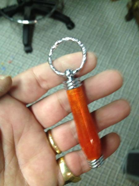

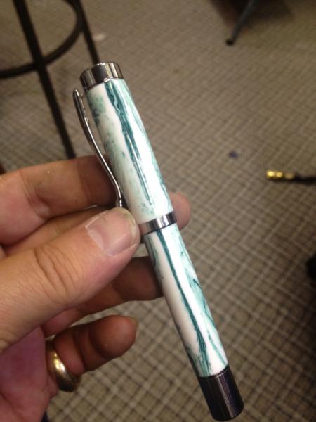

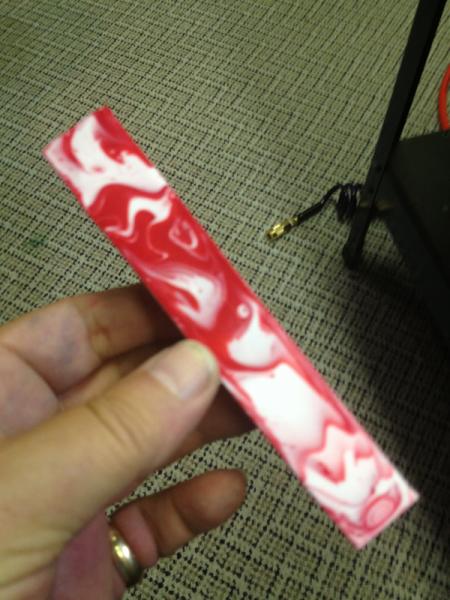

Colors don't blend very much, but do a little. Sparkle in the white Alumilite won't show much, if any. Alumilite clear is what you want when using mica's for the "sparkle"!

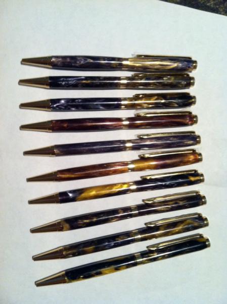

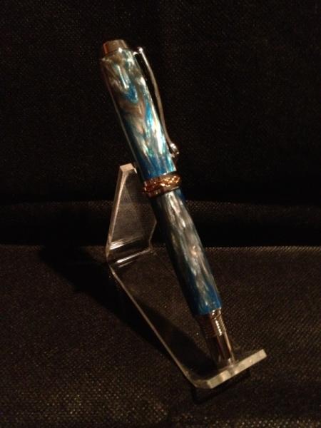

Alumilite clear pics....

Do remember that you only have 2mins to get alumilite white under pressure! That means you really only have 30secs-1min to mix any colors in before getting it sealed in the pressure pot. Alumilite clear you have 7mins which is plenty of time.
