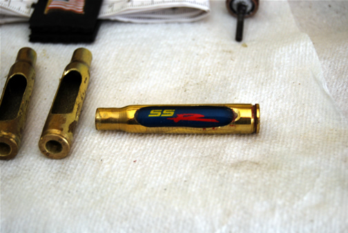

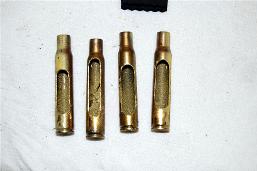

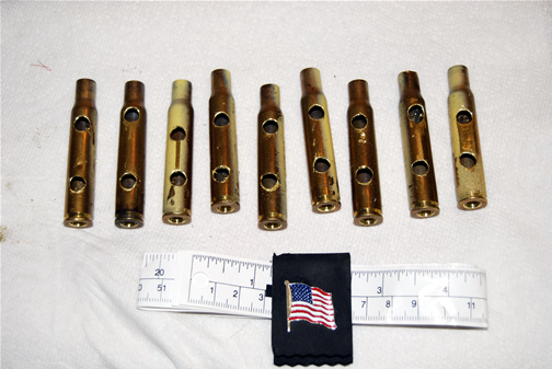

Getting ready for my third try. I am going to insert a labeled tube inside the bullet, heat it, pour the Alluite into it, put it into the mold and flood it with the rest of the Allimilte, stick it into the painters pot 60 lbs, 45 min, and then bake at 150 for 30 more minutes.
