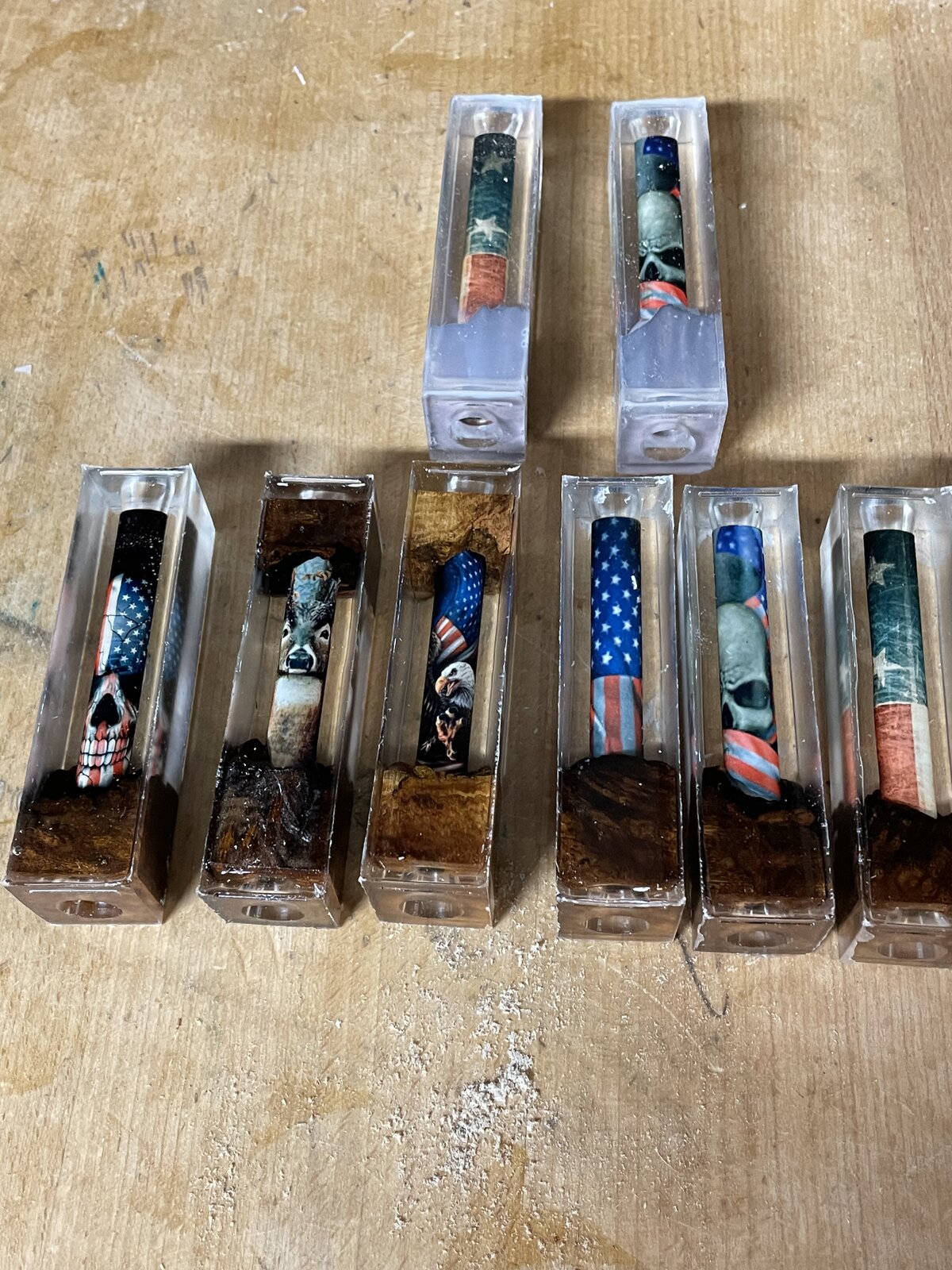

If I use a vinyl backing on watch parts pens, the urethane tends to pull away from the vinyl. When clear casting a hybrid , any residual moisture in the wood, even stabilized wood, turns hazy where the resin meets the wood. Liquid Diamonds isn't affected by it. Liquid Diamonds works well in both scenarios.

Yes extremely clear and turns easily. They say it doesn't need to be under pressure but I still put it in my pressure pot. Once under pressure it needs to stay in the pot for 24 hours. I have a few coming out in about an hour. They are clear cast hybrids. I'll post them later.

Kenny. Look at this picture. Top two were Alumilite Clear, notice how hazy it is anywhere near the wood. The bottom ones are all Liquid Diamonds, clear as a bell. In the same batch of the Alumilite, I also had some without wood, they turned out very clear too, without any hazing. I don't see many making clear cast hybrids, like these. I really like them. Can you tell?😜

Those are sweet. I see the deer again!! I understand wanting a clear blank and if it works for you them by all means use it. Like I said I wasn't wanting to try to change your mind just making sure I wasn't missing out on something. I see and read people doing g things I could never get to work. Doesn't mean it's bad just not for me. I do appreciate your openness to teach and direct others to a better turning experience. Thanks
The haze is caused from the moisture in the wood, the wood should be bone dry if used with polyurathane (alumilite clear or clear slow). Best practice would be to put the wood in a toaster oven at 101 C (214F) prior to make sure its dry. You can also precoat the wood with epoxy and let it completely cure, then you can cast it with alumilite clear/clear slow.
Yes, I know that. All that is unnecessary with liquid diamonds, kind of my point.
All of that is pretty much unnecessary with epoxy resins, of which Liquid Diamonds is a good low viscosity one with good machinability once fully cured.
