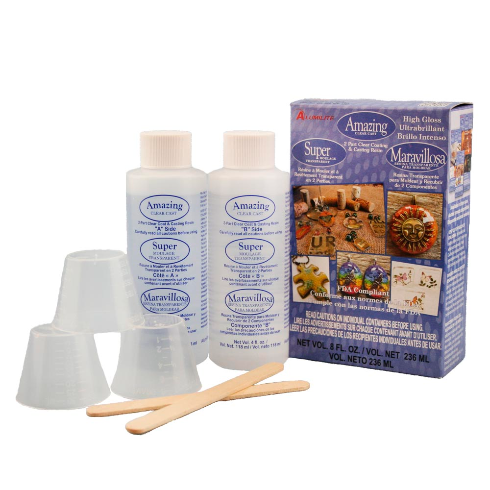

The product I used was this:
I scanned the QR code and watched the videos. It told me one to one volume or weight. I weighed it but I also compared the volume. The bottles were at the same level so I assumed I was good for volume and weight. I should know by know not to assume. Sounds like my best bet is to give it a few days and see if it hardens up a bit.
